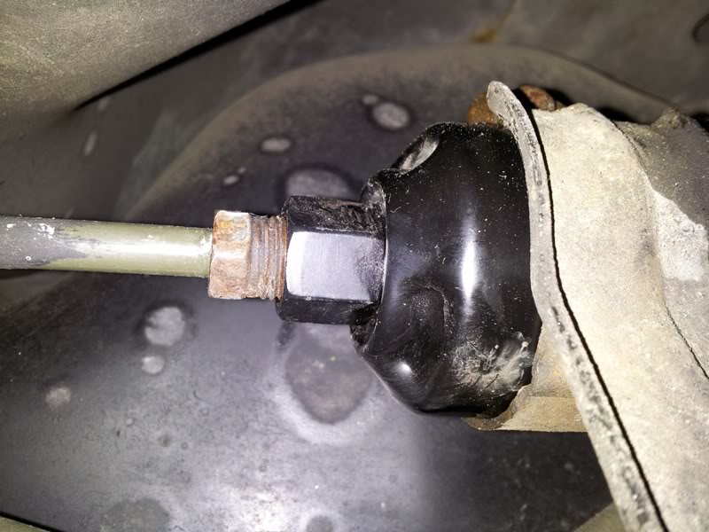

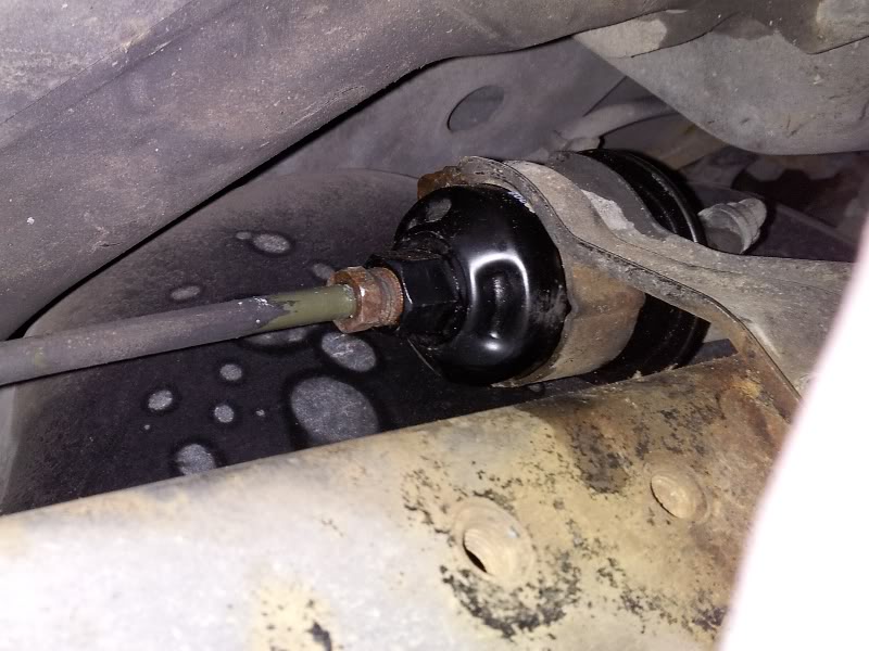

He specifically mentioned a 2001 Montero Limited. The full sized 01 Montero does NOT HAVE a replaceable fuel filter. It has a filter built into the fuel pump module that is located INSIDE THE TANK. If you had a 2001 Montero Sport Limited, that has a fuel filter at the drivers side frame rail at the rear, just beneath the rear passener door. It requires a 19MM wrench to hold the filter, a 14mm flair nut wrench to loosen the fitting. That is for the fuel filter inlet. The outlet side you'll just need to pinch with your fingers as you push the filter into the hose... it's a quick release type fitting. 2 12mm bolts hold the filter in place... and it's out. Reverse the procedure for installation.

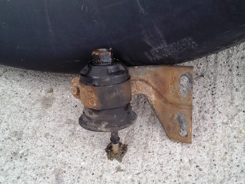

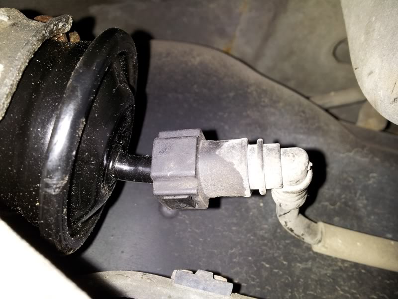

Just to add something visual for people like me who needs to see what we are dealing with. Hahaha! Like Joel_CA said and it's pretty straight forward!
Attachment 6024
Attachment 6025
Attachment 6026
Attachment 6027

Terylsdad, thanks for the photos. Im helping my son change the fuel filter on his 2000 Montero Sport and we are having a hard time disconnecting the quick connect side of the filter. Do you need a special disconnect tool, and if so which one? Thanks to anyone that is able to help me with this.
