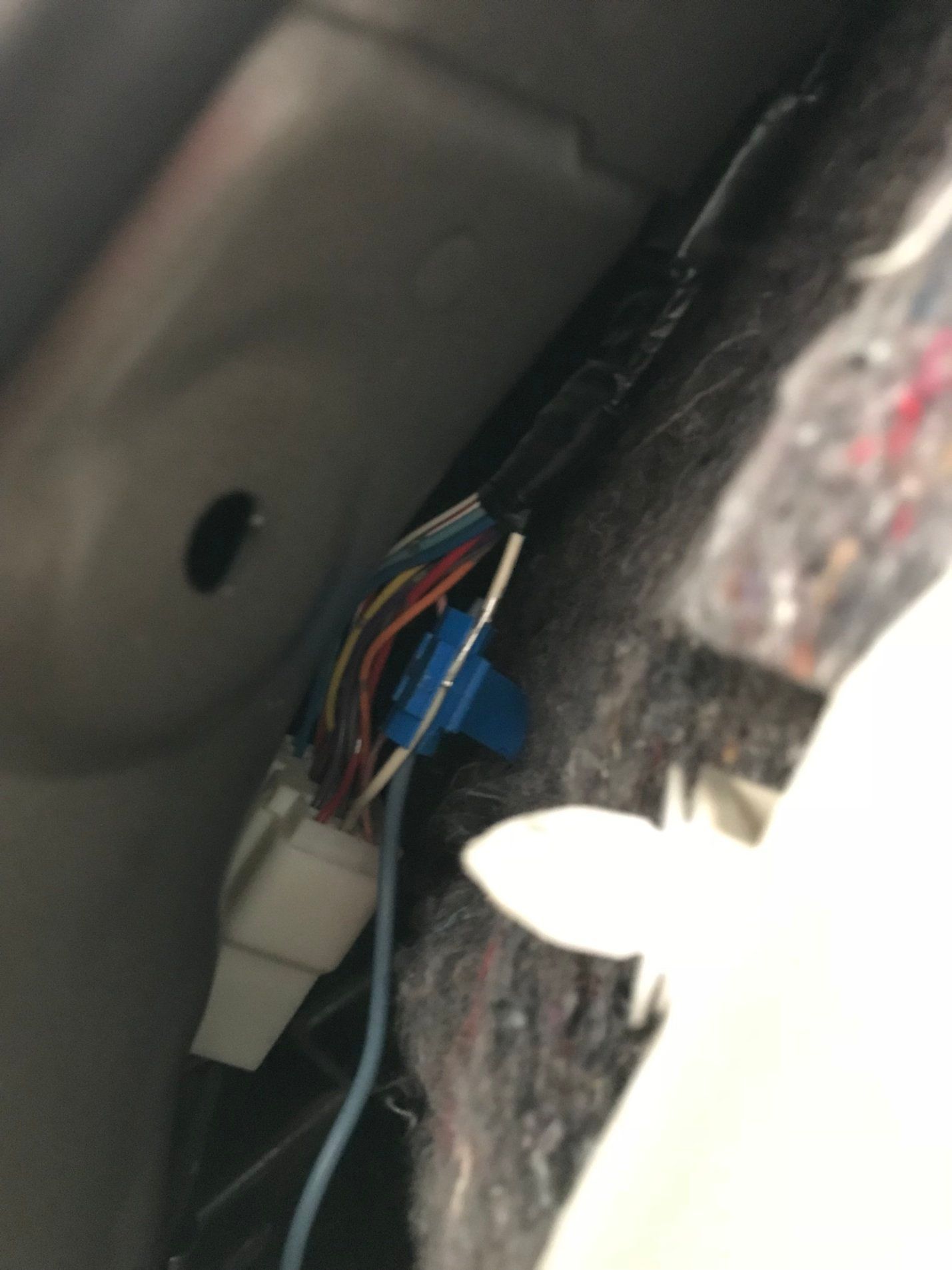

bradz Jul 23, 2011 09:05 PM
5 pin trailer wiring
I need help. I just put in a 5 pin plug for my trailer that has hydrolic brakes but i cant find a way to connect to the reverse light line to my mitsubishi outlander for the brakes to disengage. I have looked at the post for a 4 pin trailer plug but cant find the info i ned for the last wire. There has to be a nother point that i can access this line rather than running up into the hatch door.

Cali Duck Jun 26, 2018 11:30 AM
I figured it out myself.
Used a multimeter to try and locate a reverse wire under the cargo holder over the passenger rear fender well, but I couldn't find it.
In looking at the reverse bulbs, the cables were routed to the driver side.
I pulled back the panels and found the reverse wire - it was white with 2 grey stripes.
Tested with my multimeter to confirm. Hope this helps!
https://cimg5.ibsrv.net/gimg/mitsubi...c5b6d3363.jpeg
