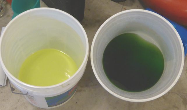

One thing I noticed during this process is that it takes very little of the old, dark green coolant to "color" the new, amber-colored coolant/water 50% mixture, as show in the below photo taken after 3rd drain (about 12% old coolant); fill with 50%; run-engine-to-mix cycles. (Right now, as I type, I've got the 4th fill in the radiator waiting for some place to drive in order to completely mix the coolant for the 4th time.)
I've still got the plastic shield off the bottom of the vehicle. I'm now debating how many more, if any, cycles I should perform. To go further would constitute a severe example of the law of diminishing returns. I figure that after mixing, the amount of original coolant in the engine will be around 6 or 7% of the present mixture, yet, if I were to drain it, the color would most likely still look amazingly similar to what the first drain of old coolant looked like.
