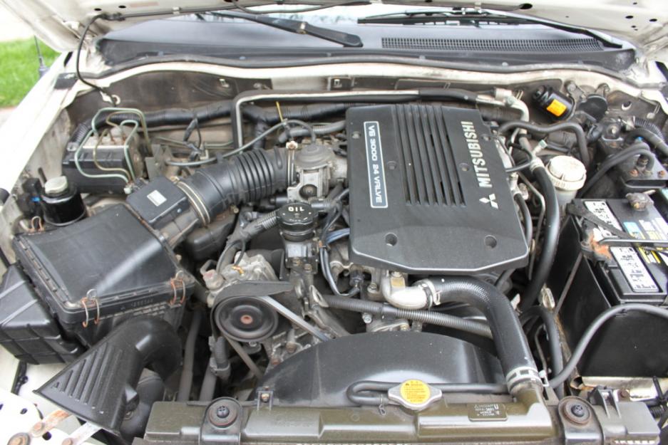

Hi guys,
I just got my car and i'm Broke :P >
I did get the manual for the car - an online one though ... didnt really think it was amazingly useful, maybe its me, or the version i have !!!
Anyways, i have no experience at all in cars, nor do i have any tools, was wondering whether any1 can at least show me where the valve cover gasgets are...
how difficult is it to change it ... i looked under the hood and if i'm not mistaken i thought that there were piles of stuff over it ... i actually thought that there are motor parts over it ! i'm confused ...
Is there any1 that can help this amature start working on it ...
I can Post pictures for it ...
The pic i attached is just one from e-bay to let you know what im talking about ...
I'd really appreciate any help . No videos on youtube for montero's ...

Hi:
Why do you think it needs valve cover gaskets?
Most oil leak problems on that engine are due to things called rear cam plug o-rings or seals going bad. If the oil seems to be coming from the rear of the engine and drippig down on the exhaust pipes this may be your problem. It
s very common and fairly easy and cheap to fix - although you will need to get a few tools and read up on it in this forum - use the Search function for "rear cam seals" or o-rings.
On the other hand if you really do need valve cover gaskets (what are your symptoms?) that's a much bigger project and honestly not something you would want to attempt yourself based on your statements.

Welcome to the forums....
So why didn't the manual you have provide you any joy? Try this link and see the illustrations which will at least give you an understanding of your engine's layout and what's involved in replacing the gaskets should that indeed be necessary.
http://www.pajero4x4.ru/piii/
You should also beg, borrow or steal (not really, but I hate to break up a set ) a basic set of metric sockets and wrenches, not to mention a torque wrench in order to put anything you've removed back in the proper way. It's money spent up front that will pay you back later.
But jrmdir is right in asking why you're certain you need to do this? Let's get that horse up in front of the cart where he belongs...
