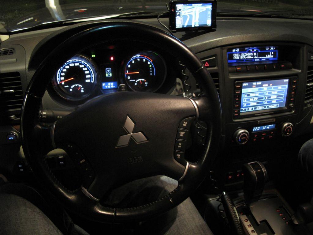

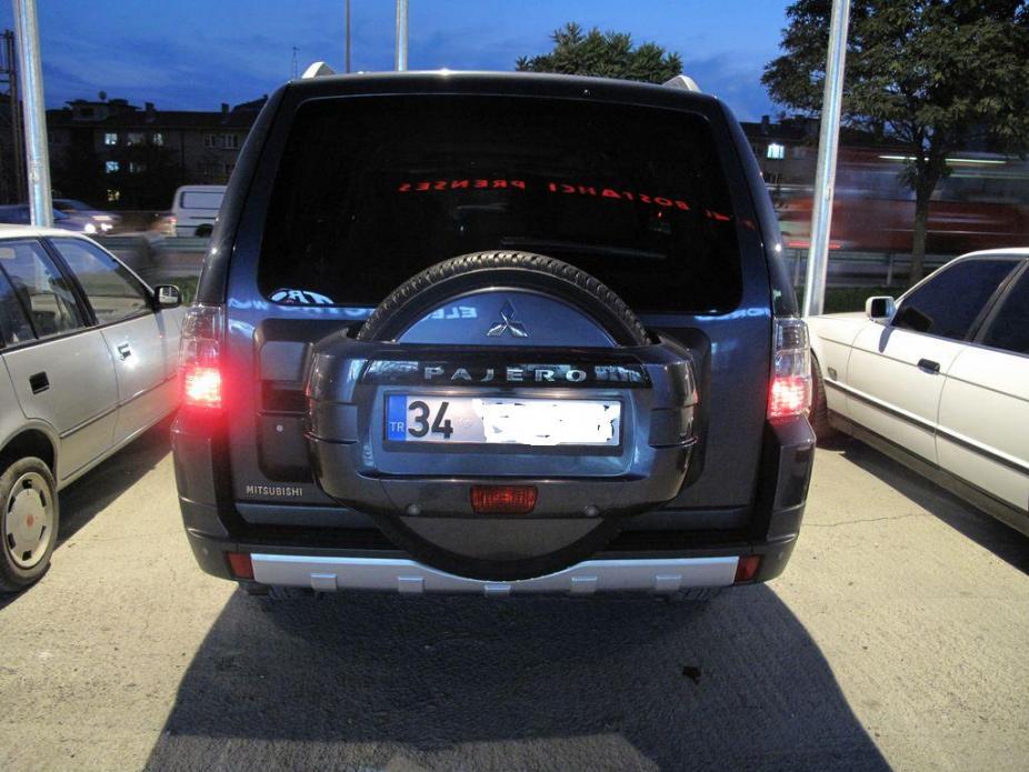

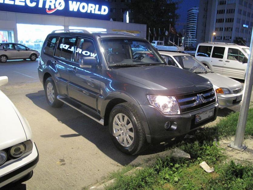

Originally Posted by redturboeclipse
Damn the newer Pajero/Montero after they stopped releasing it in the USA at 06 looks nice! Can you just show us more pictures of your car in general, I reallyl ike that interior.
Here are the pics for you
Attached Thumbnails  VIDEO AUX in on Pajero 2008 w/ MMCS-img_0637.jpg    VIDEO AUX in on Pajero 2008 w/ MMCS-img_0623.jpg    VIDEO AUX in on Pajero 2008 w/ MMCS-img_0619.jpg

damn the interior is so much nicer. very updated with the times. I really like the new front end too.
