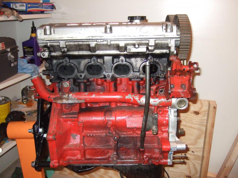

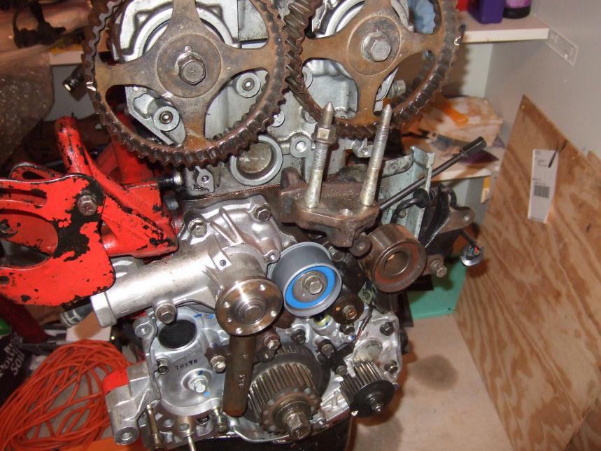

just an update for you guys... our son was born a couple of weeks back and I haven't been able to do anything with the engine until last night. The tensioner and idler pulley looked a little rusty so i replaced those. I pulled all the spark plugs and looked down into the chambers. the pistons are nice and shiney; no carbon. i can't tell if theey looked pitted or if it was air bubbles, but all the pictures i've seen online suggest that they are fine. I pulled the valve cover and the head looks brand new on the inside... its probably the cleanest head i've ever seen...
The only issues with the engine are the damaged parts from shipping, the intake manifold was put on with a cork gasket, and there seems to be oil leaking into the #4 exhaust port (i'm attributing this to the engine laying on that side when it was shipped: YAY UPS freight). Also, the number 1 spark plug was soaked in unburned fuel, as well as the intake port for that cylinder. again, not a big issue
this head's intake ports are ported to hell and back... knife edged dividers, and smoothed very nicely... the guides look nicked on the outside, but that shouldn't affect anything as long as the seals are good. I'll try to keep a "picture diary" of the swap and build-up for you guys.. and if you have any specific questions I can take pictures of that as well. Later guys

I did a little more work tonight. I removed the bc 272's from the new engine. Removed the intake manifold from my old engine, removed the a/c lines.. still have to tackle the compressor and condensor. below are some pictures of my progress as well as my new engine. I also put some things on ebay. Let me know if the prices seem reasonable.
