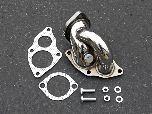

oh almost forgot, at this point boost creep is driving me crazy. do yourself a favor and get an external wastegate.

You could aways run an 02 dump, thats a cheap way to eliminate creep.

an o2 dump??? what is that
Old Sep 29, 2009 | 07:00 AM
An o2 dump is a pipe that just dumps the air comming from the wastegate to the air instead of back into the exhaust.
Notice a normal o2 housing looks like this where the wastegate is routed back to the exhaust downpipe
and here is a dump pipe
