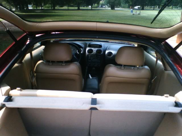

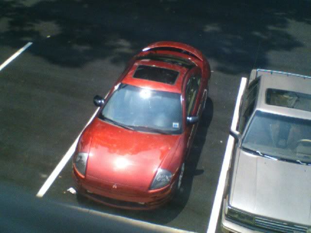

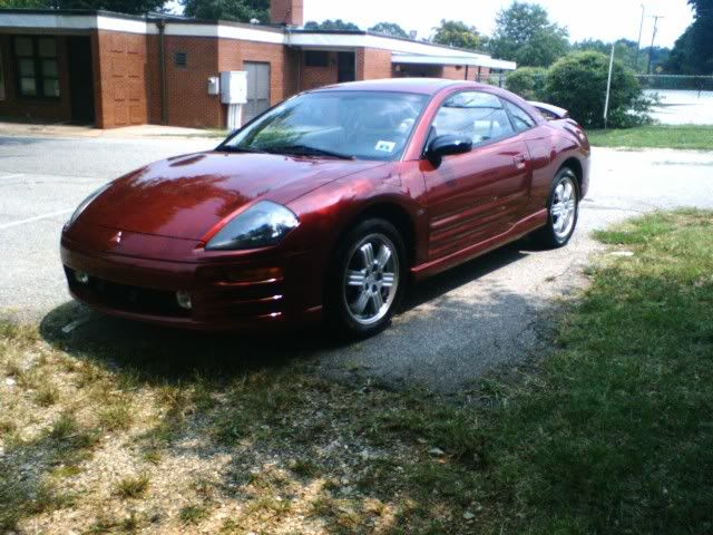

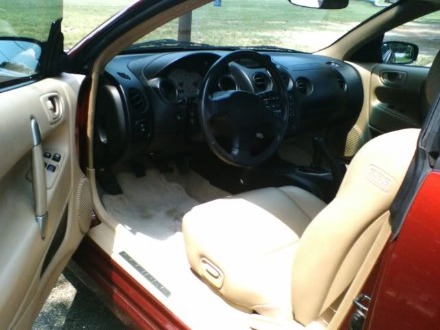

Here are the pics, like I said it's all stock and I don't really plan on doing anything to it, it's temp. until I can get an AWD or RWD car. preferebly a GSX or a 300ZX.

yay same color as my bros 3g! only his is a 4 cylinder lol nice car!
