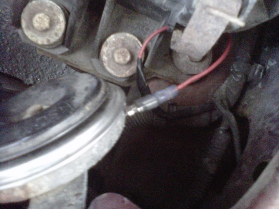

No, mine did not make any sound under the hood, just the lights blinking. I got it fixed changing the conector of the alarm (right next to the driver side headlight under the hood). I leave you a picture hope it will help. Check the circuit or the connectors, it may be the problem.

Okay, thank you for the picture. I'm pretty sure that is what it looks like on my car.
I'll check it today.
