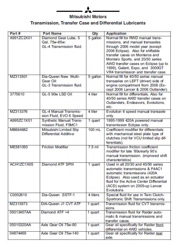

this is from Mitsubishi for North America, not sure because the CVT didn't come in Lancers of those years in NA. But you might assume the CVT fluid would work.

Thanks
So which means I could safely use this in a F1C1 transmission
