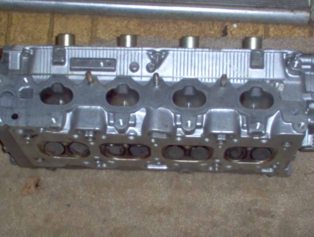

I bought a Spyder that had the engine tore down. Well, when I had a machine shop check the head for cracks and other problems, they told me that it wasn't for the Spyder. It turned out to be a mirror image of the head I needed. I've tried many times to identify what Mitsubishi vehicle this engine goes to but haven't been successful. I know it goes to a 2.4L SOHC. The numbers on the head are "G6E4". Any help would be appreciated.

Can you post pics?

maybe its from a newer 3g eclipse

Here's a few pics.
Attached Thumbnails Need help identifying a head.-im000893.jpg   Need help identifying a head.-im000892.jpg   Need help identifying a head.-im000891.jpg

pretty sure it's from a 2.4L 4G64 engine from a 3rd Gen Eclipse. It's the same 4G64 engine as in a 2nd Gen just with the intake exhaust sides swapped. Intake in front on the 2nd Gen and intake in rear on the 3rd Gen.
