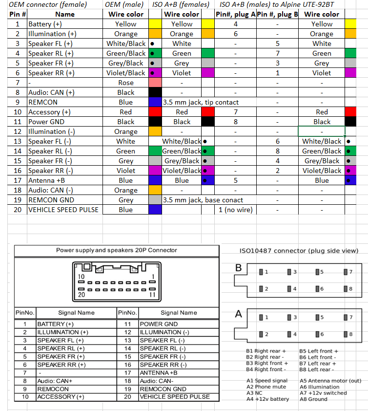

Mitsubishi Bluetooth module is a bad product. Each time I did BT software upgrades it fixed some bugs but introduced new ones. Horrible...
Another issue with BT module I had was to play properly mp3 files. Somehow Mitsubishi decided to play them on BT module instead of the radio unit. Why? As consultant working in IT I can only conclude that this is a bad system design from the beginning, thus, software upgrades will unlikely help.
I took OEM BT module out of my Outlander III 2013 and sold it on eBay for $50, then I even replaced Mitsubishi radio with Alpine UTE-92BT without CD (who needs CD player nowadays?). The Bluetooth/handsfree/music_streaming_via_BT functionalities are working flawlessly and I even managed to connect controls on the steering wheel. There are plenty of aftermarket car radios in 1din or 2din format or Android based units with touchscreen, back camera connectivity etc. I needed 1din radio with BT/handsfree and possibility to have additional storage pocket under the radio (that's why 1din).
My Alpine unit came with a microphone which I placed closer to the driver, what idiot at Mitsubishi designed and placed it on a ceiling near room lamp? People could not hear me when I was driving and talking via handsfree with OEM Mitsubishi radio.
The only thing I had to make was an adapter from OEM 20pins mitsu connector to standard ISO car radio, see pictures. The 20pins connector (male if I recall correctly) I bought from AliExpress or something for $2-5.
