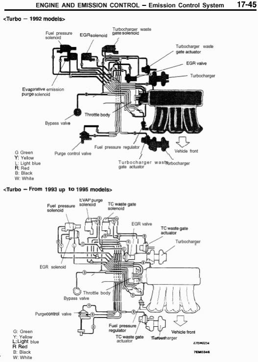

Old Mar 30, 2013 | 10:15 AM
toddrs93's Avatar
Joined: Oct 2009
Posts: 58
Usually vacuum leaks or spark related. Replace plugs and wires and check vac lines
Attached Thumbnails ``my 3000gt vr4 bogs when my boost hits 14lbs...what could it be??????-image.jpg
