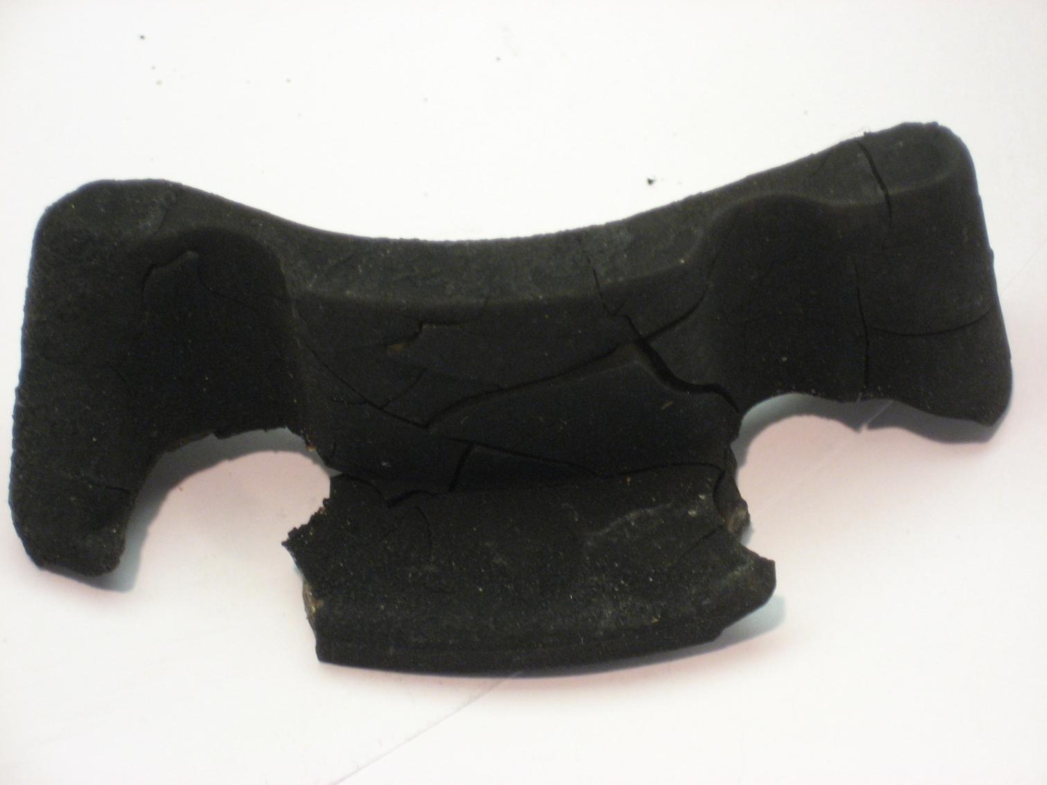

I found a part on the garage floor under my 1999 Diamante. It appears to be made from plastic or polyurethane. One side is ragged like it broke off from the rest of the part. Only problem is that I cannot identify where it came from. I don't think it is exhaust system related because it probably couldn't take the heat. It looks like the material the strut shock bumpers are made from. I have checked through the factory manual and looked under the car, but do not see where it came from.
I have attached pictures from the top and bottom, though I am not sure which side is really the top. The length is 3.25 inches.
Anybody recognize this part?

I found what it is. A stone deflector for the corner where the floorpan, inner fender and rocker panel meet in the right rear of the underbody. I found the mounting screws and remaining pieces still in place there. I checked the other side of the car and that deflector is already gone. I can't find the part listed in any diagram or service manual. I will just leave it as it is.
