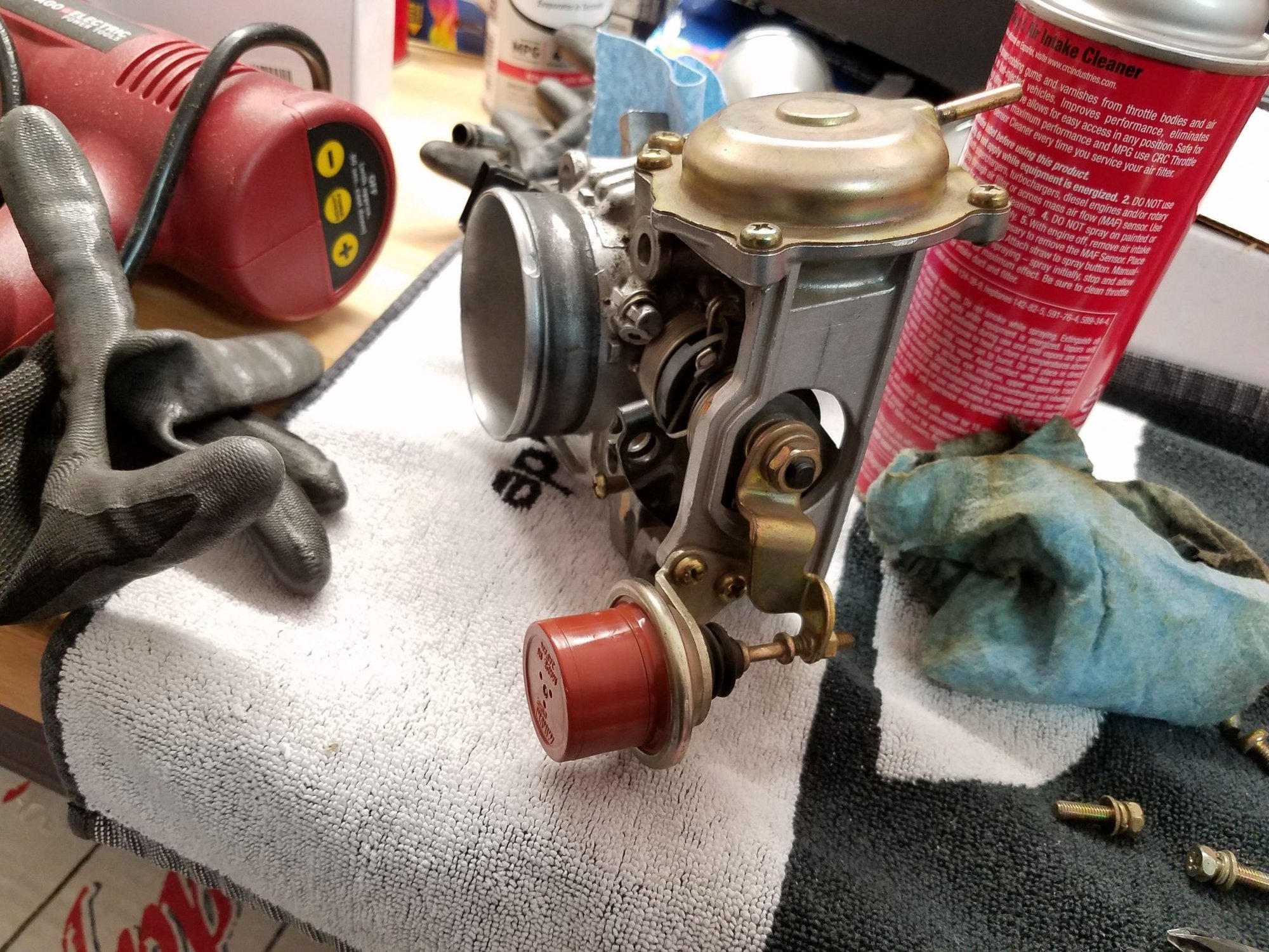

Old Jan 12, 2020 | 01:50 PM
Diam2002's Avatar
Joined: Mar 2011
Posts: 54
From: Northern AZ
I am cleaning the throttle body on my 2002 Diamante in order to solve a stalling issue. The small red round red plunger style device has no wires or vacuum lines connected to it however the boot looks worn and tired. Not sure if this is the issue but I can not find any reference to this part in the shop manual. Does anybody know what it is and its function or impact to Idle ?
What is the round Red mechanism?
