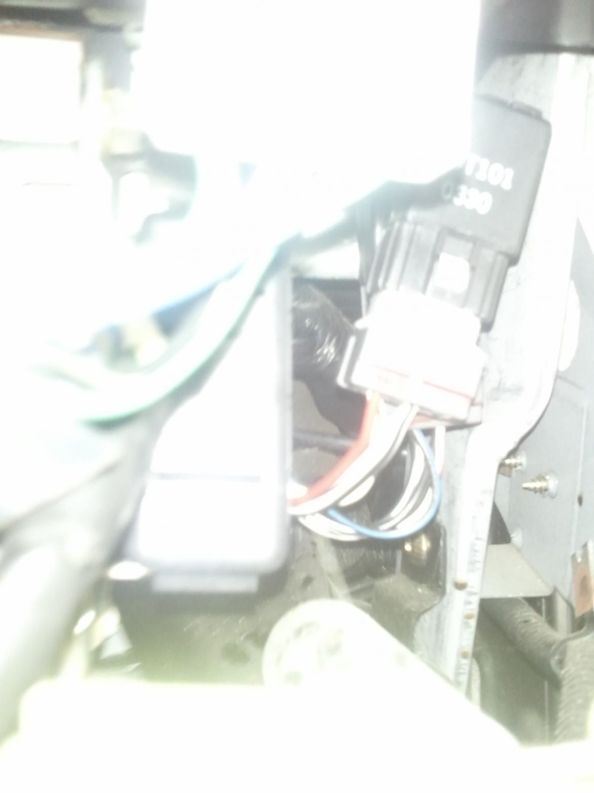

There should only be one relay, the one in the picture is the one you want for AT.
The picture at the bottom where the relay is mounted, behind it is the ECU and it should have a plastic cover over it. If that cover is wet with green radiator fluid I suggest eliminating the heater and splicing the hoses together.

So, only 1 transmission relay then? since you take out the ash tray all in the front did you see the one i am talking about. It is also a relay. i took a picture of it with my phone, i take out the cup holder. can you take a look of it? there is another relay behind it with the same number.

The image is small and i don't know how to edit it to make it bigger but see that's a relay and there are 2 of them with the same number. I wonder if you notice those when you take out the ash tray under the car stereo.
