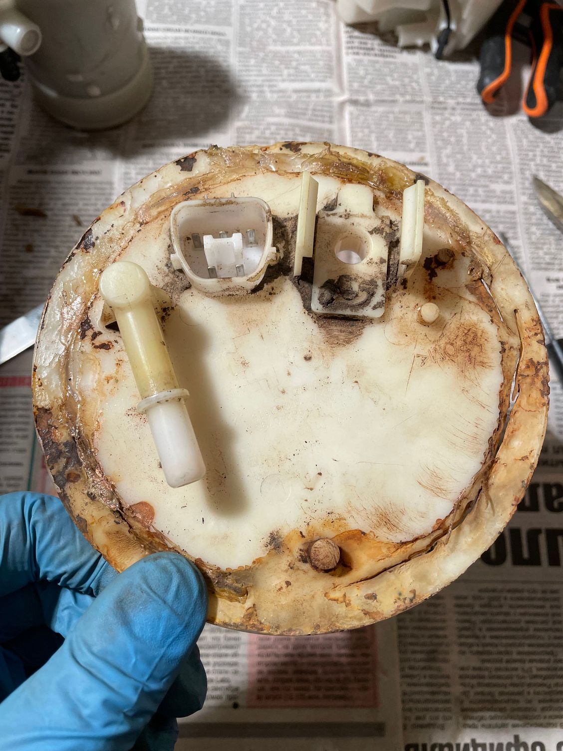

Upon inspecting the old module, I found myself knee-deep in rust and grime, a testament to the fact that perhaps I was the first to peer into its depths in quite some time. The module's cover revealed the following details:

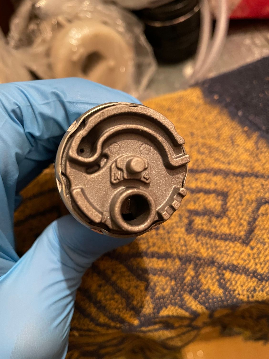

However, the fuel pump itself bore a different inscription:
DENSO AF195150-7290 09H11.

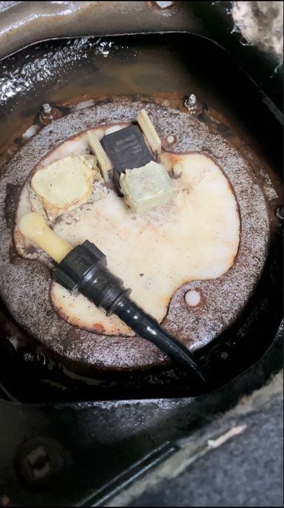

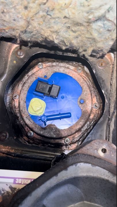

Under left rear seat, here is the service hole cover.

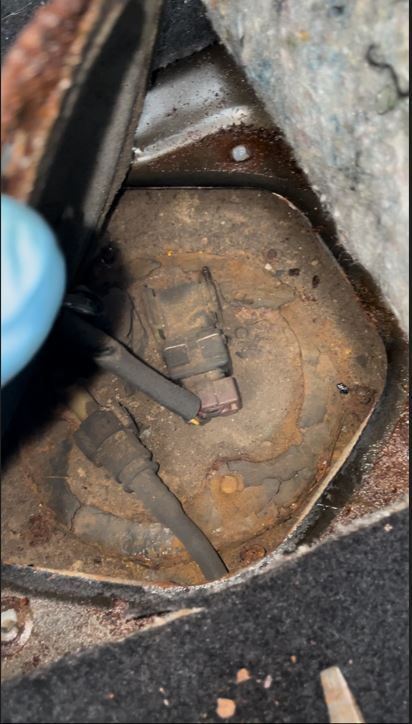

High pressure hose, Fuel Tank differential pressure sensor connector and the Pump module connector.
when the cover is removed, you can see all that rust and dirt
I cleaned everything for a long time and sprayed it with an anti-corrosion agent to loosen the nuts, some had to be cut out because they were rusted
Removing plate. it can be seen that the top is all cracked and needs to be replaced

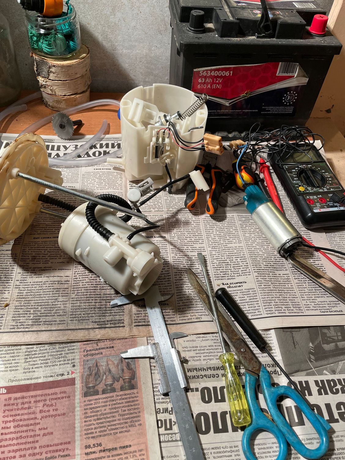

Old Fuel pump module assembly
I ordered this part, & I'm still waiting. This is all I actually need to rebuild old module.

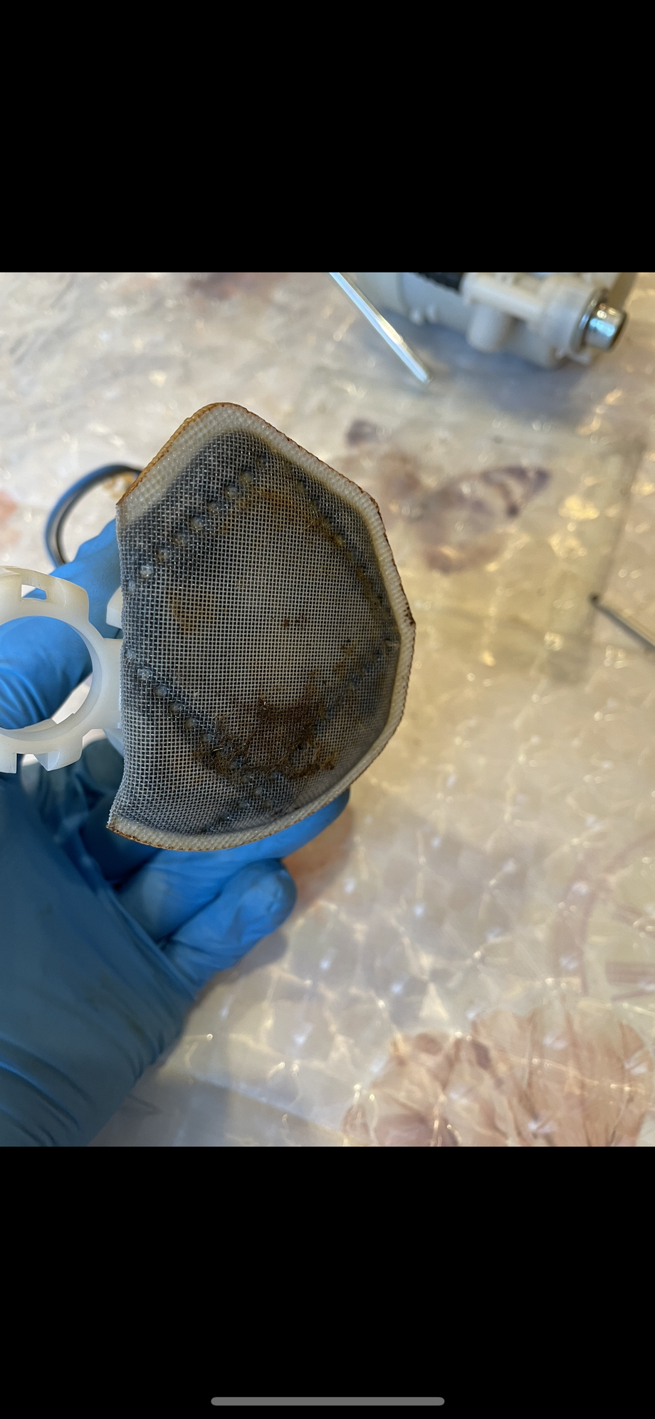

dirt that has accumulated in the lower part of the module and has not passed through the strainer
Fuel Pump
Bottom of the pump

Strainer, also should be white

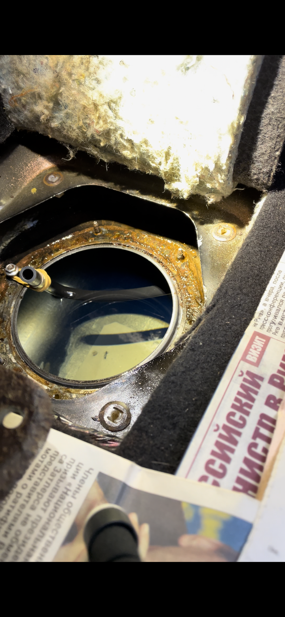

suction hose. although everything around was dirty, inside the gas tank was surprisingly clean
