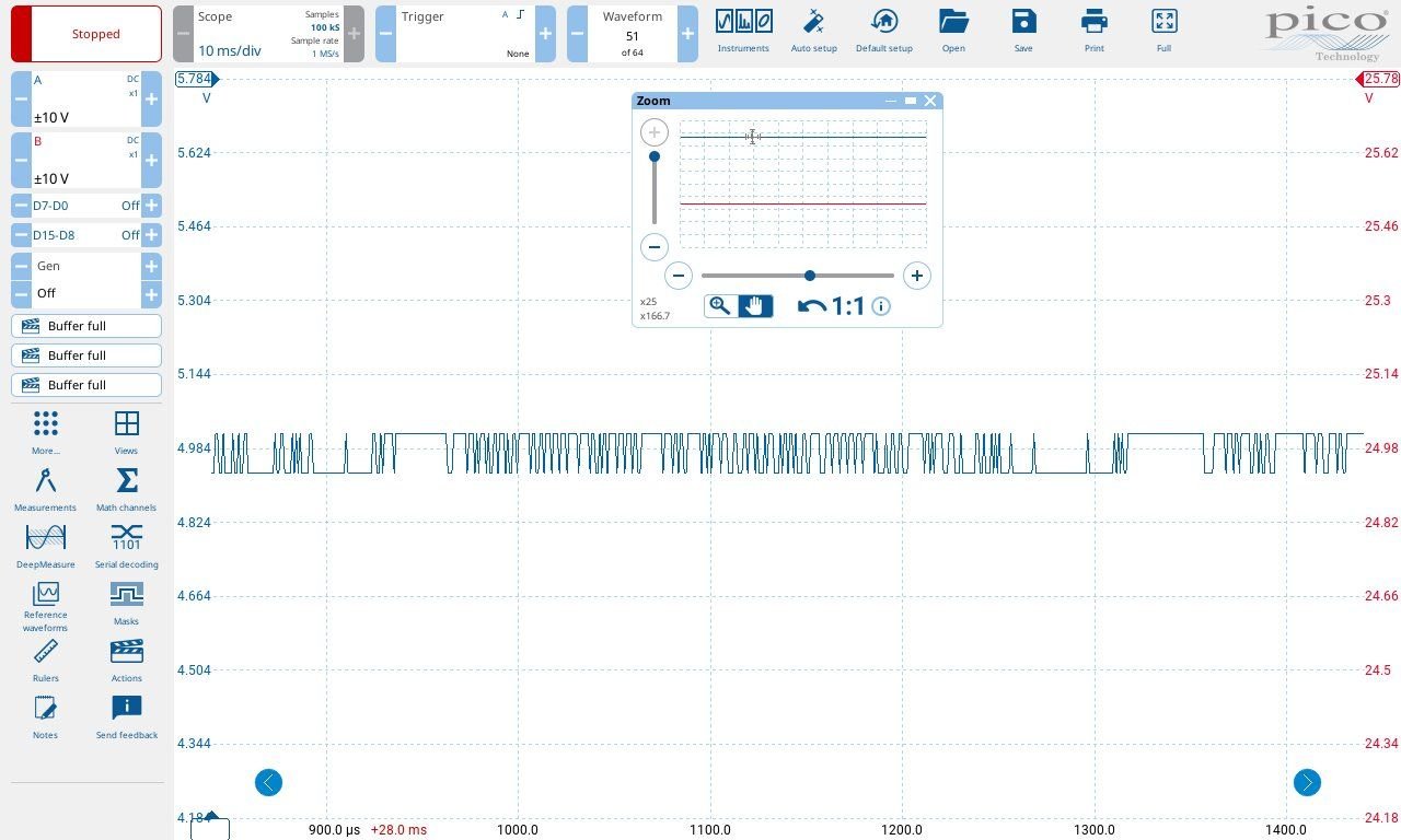

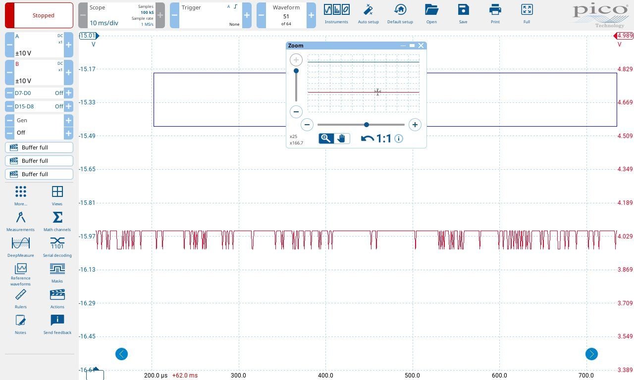

MAF Sensor. The manual only says that at 700 RPMs it should be generating 25-45 Hz, at 2000 RPMs: 85-105 Hz, and when racing the engine: increase., so I made some wires to put the scope on the various signals. This is from the schematic in the manual:
It appears that the WB and R pins are not connected. Put the probes on GY and P. These are the traces I saw. They certainly don't look right. Large DC offset and tiny signal.

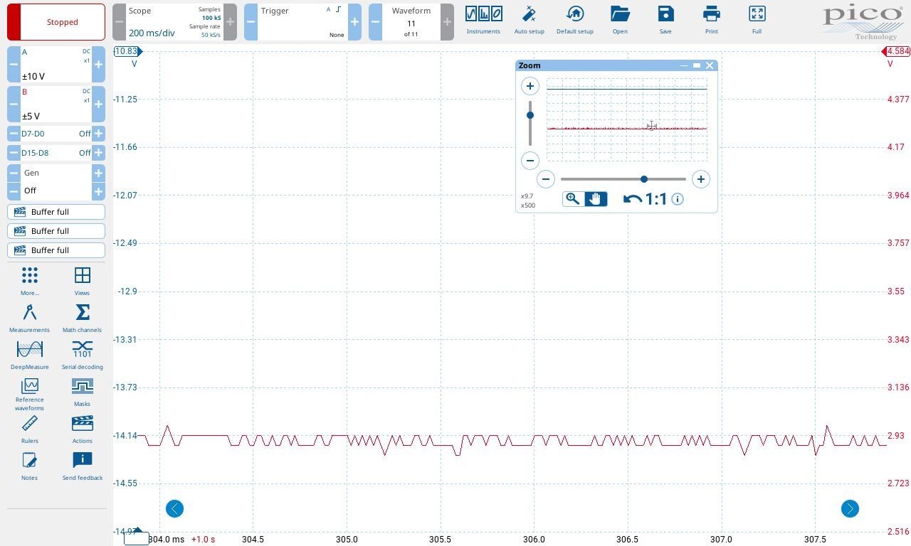

I also tested pin RB (the heater). This is the trace I got:
All referenced to ground (pin B)
Does this look right? Can anybody confirm that these traces are not normal? I'd rather not buy a new MAF sensor if this one is working properly as it's quite expensive (~$150).

What would cause the signal to be stuck at 4V? Would cleaning the sensor with compressed air be advisable? Do I need to buy a new MAF sensor?
