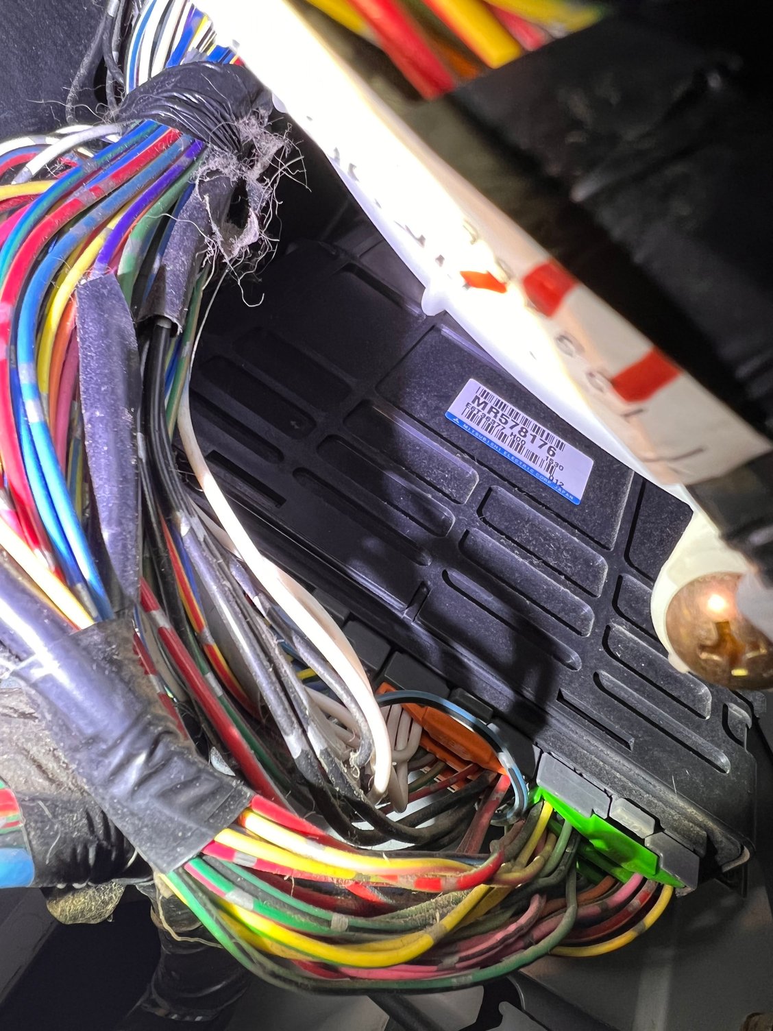

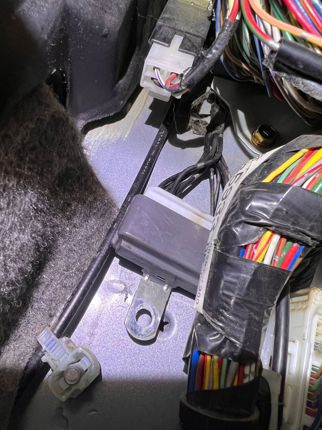

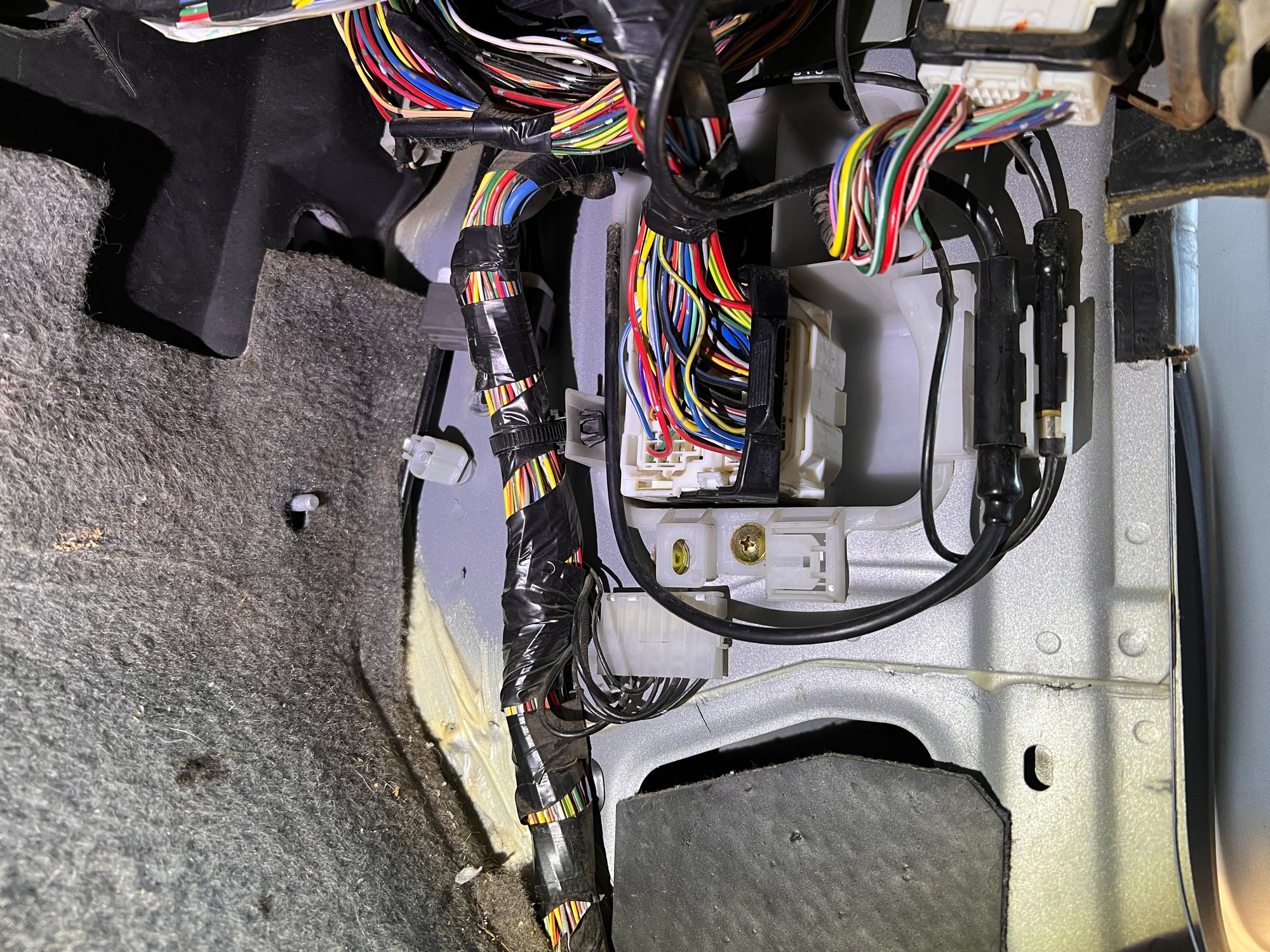

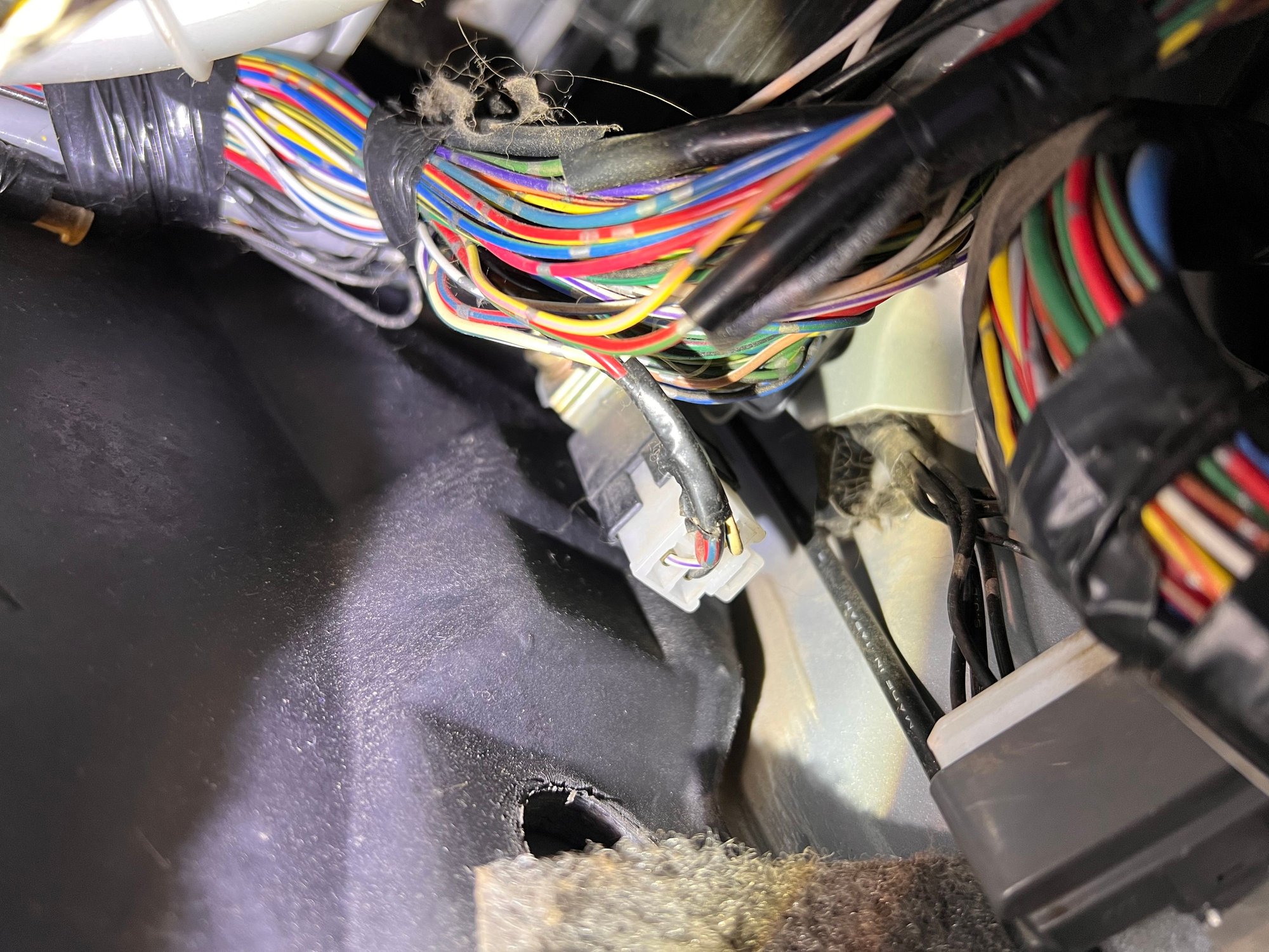

I spent the last few days really cleaning all the connections and grounds and it started finally but it’s still spotty and the starter still didn’t disengage. I did hear a clicking coming from the passenger side kick panel so I removed it and found a mouse nest 🙄 cleaned that up and found some connections and I think some relays. I know that the ecu is right there but I can’t figure out these others.
this is the ecu if I’m not mistaken ^
