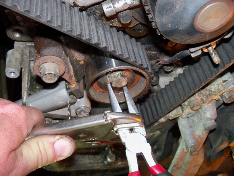

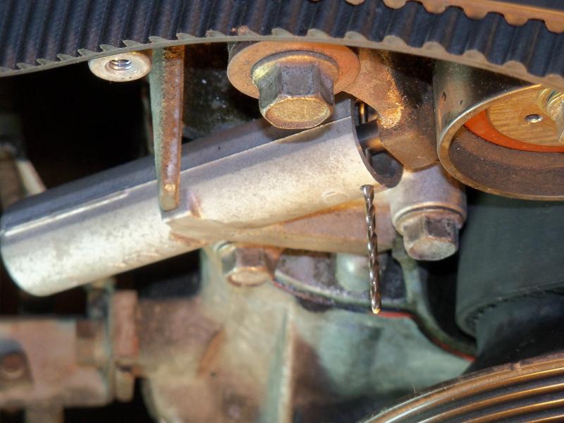

You might have to remove the crankshaft pulley again to replace the belt. Do that, and then remount the pulley after the belt is looped on. Now with the new belt on and the pin in place in the adjuster, mount the adjuster back on.

Now comes the fun part. There is a tool from mitsubishi the you can get to hold the tensioner and put a torque wrench on. If so, use tool p/n MD998767 and temporarily tighten the tensioner bolt. now turn the crankshaft nut, which is inside the crankshaft pulley, a 1/4 turn counterclockwise, then clockwise again. Make sure the timing marks all line up again! If so, and no more further adjustments need to be made to the belt timing, then loosen the tensioner nut and turn the timing belt tensioner upwards to 3.24 ft/lbs and tighten it. I, on the other hand, had no such access to that tool so I used a pair of needle nose pliers and a pair of vise grips and made my own tensioner tightening tool. My elbow is my calibrated torque wrench! Push down on the tensioner tightening tool ( rotate it counterclockwise). Remove the pin in the tensioner after tightening.

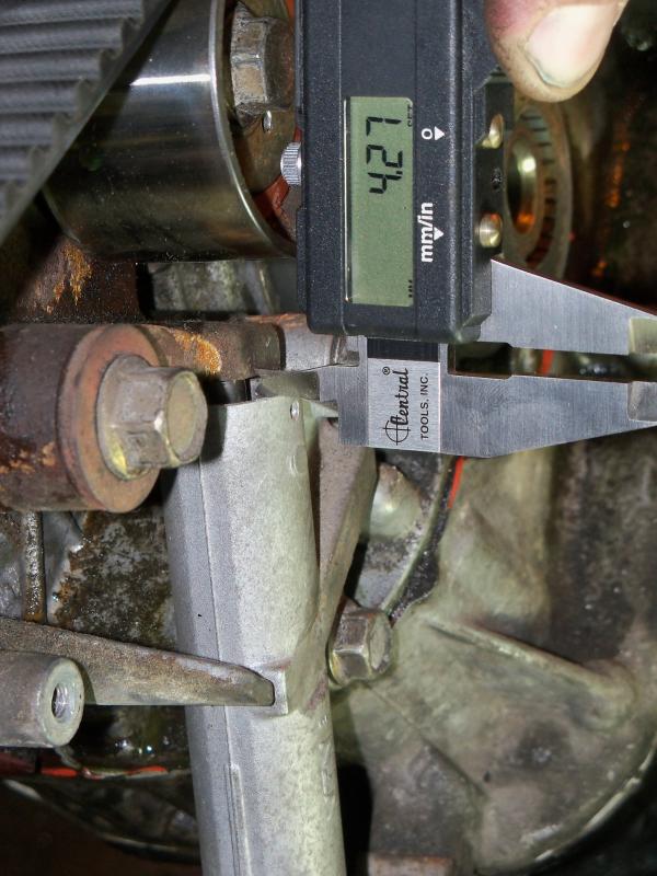

Now turn the crankshaft clockwise two full rotations and wait a couple minutes. Then check the extension of the pushrod. It should be between 3.8mm and 5mm. If not, the loosen the tensioner, reset the pin, and repeat the process. Must get the tensioner between 3.8 and 5mm.
