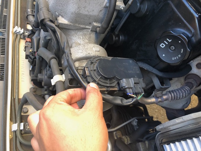

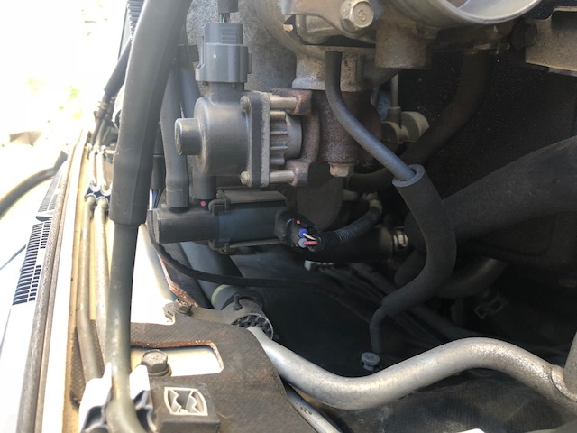

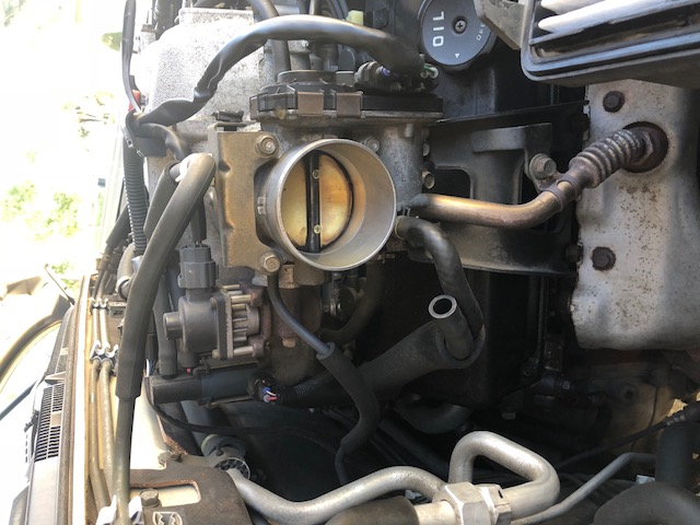

Hi ,
My montero limited 2003 stalls and dies at stop with ac...Cleaned the throttle body and maf sensor but i just cannot find the IAC .....if you have a picture or know where should i find it i will greatly appreciate.....Spend hours searching just cannot find it
