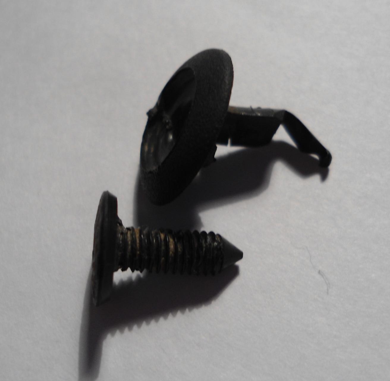

Anyways, I think the problem may be coming from a hole in the fuel filler neck (I can feel up past the guard and there is a large amount of sand stuck behind it. I just purchased a new gas cap to see if that solves the problem but putting it on and turning the car on for 30 seconds didn't turn the light off so I don't know. What I'm wondering (among many things) is if anyone knows what the part number of the clips holding the filler neck guard, I'm going to have to rip them out to get at the filler neck since they won't unscrew properly... I've includes a picture of the broken clip I already pulled out for reference.

You can most likely pick up the plastic clips at your local auto store. Bring them in to see if you can find a match.
The hole you might be referring to looks like the breather hole. Did you clean out the area that was packed with sand? Perhaps it's pinching the breather hose, so there isn't proper venting.

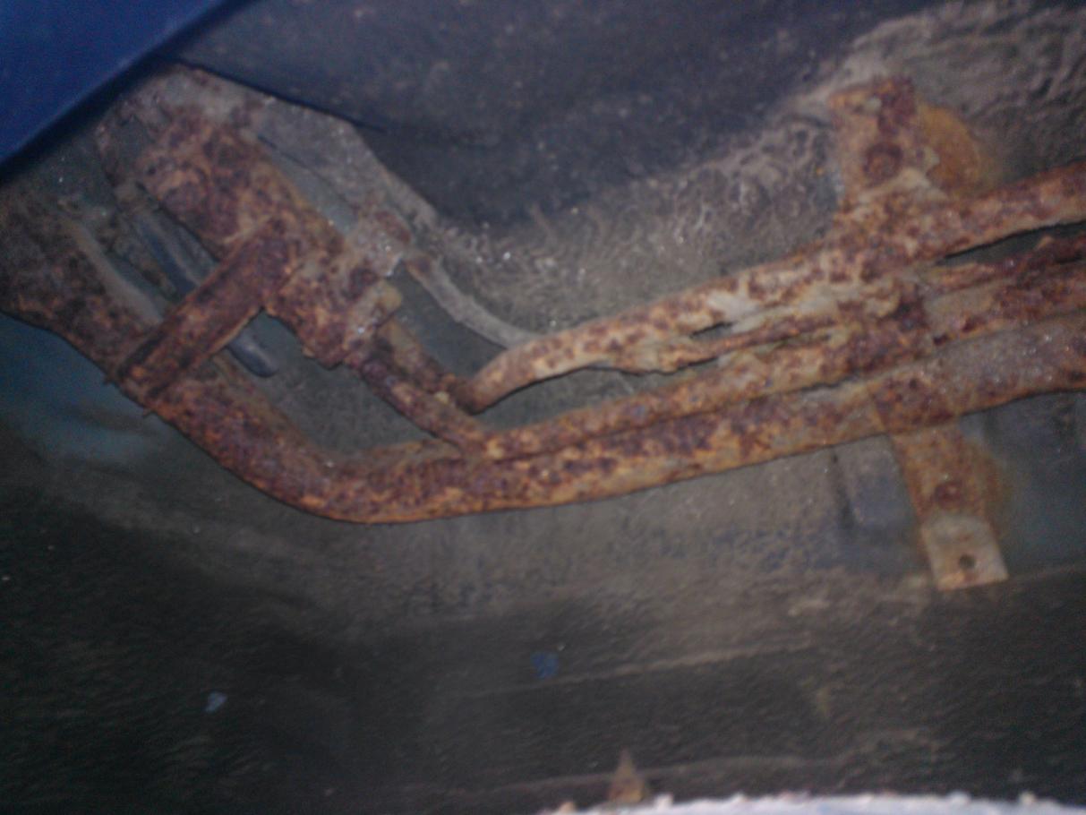

Well, I got the guard off to great disappointment. (check the picture)
It appears all the tubes (except the delivery tube) are completely rusted through. Probably stupid of me to have removed the sand and the guard because now the error code (P 0455) is on 100% of the time and I won't pass inspection until I get it fixed... I assume I'm just going to bring it to a shop since I worry about not getting the tubes back on (due to rusted mounts). I'm still debating if its cheaper for me to buy the parts and bring them than it is for them go the parts. I'm also trying to find if I can buy the whole assembly (evap tubes, etc) and not just the fuel filler tube because it appears the filler tube is in the best shape while the others are entirely rusted through...

I just bought a 2002 and realized the fuel lines and vent tubes were all rusted out. The pictures here look pretty good. I only have two lines left. The other two are gone! It is very surprising because the rest of the Mitsubishi auto tend to stand up against elements very well. Also, I am amazed there has not been a recall for this problem. When filling the gas tank, I have gas leaking out over the wheel. Seems like a tremendous fire hazard.
