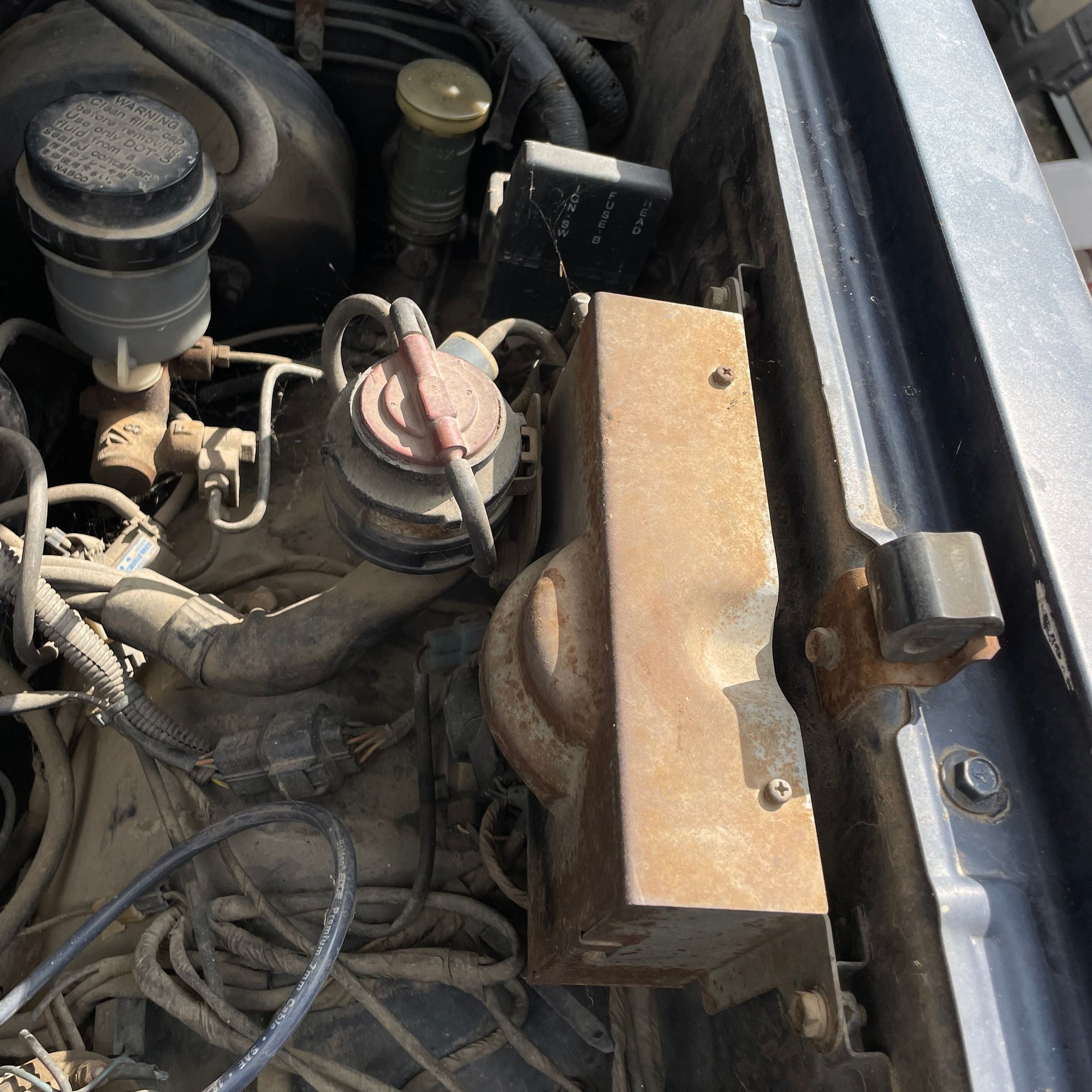

What I hear is they are default 4wd.
I understand in many models it's a vacuum line that keeps a "clutch slave cylinder" type pin depressed
If the vacuum line works, 4wd can be disengaged, but if not because of whatever causation, it will not be able to let go of 4wd and will remain, even if 4wd stick is in 2wd.
base4door May 2, 2024 12:30 PM
Check yours for the cannister somewhere underneath near the transmission, or vacuum lines around a double solenoid (each an electrical plug about thumb size)
Not sure what you've got, but early years are likely to have canister (assumption) rather than the electrical + vacuum solenoids.
Look for a rubber boot , (and not the regular drive clutch slave cylinder boot for standard transmissions), find the boot that entangles with vacuum lines and that's definitely it.
best luck.

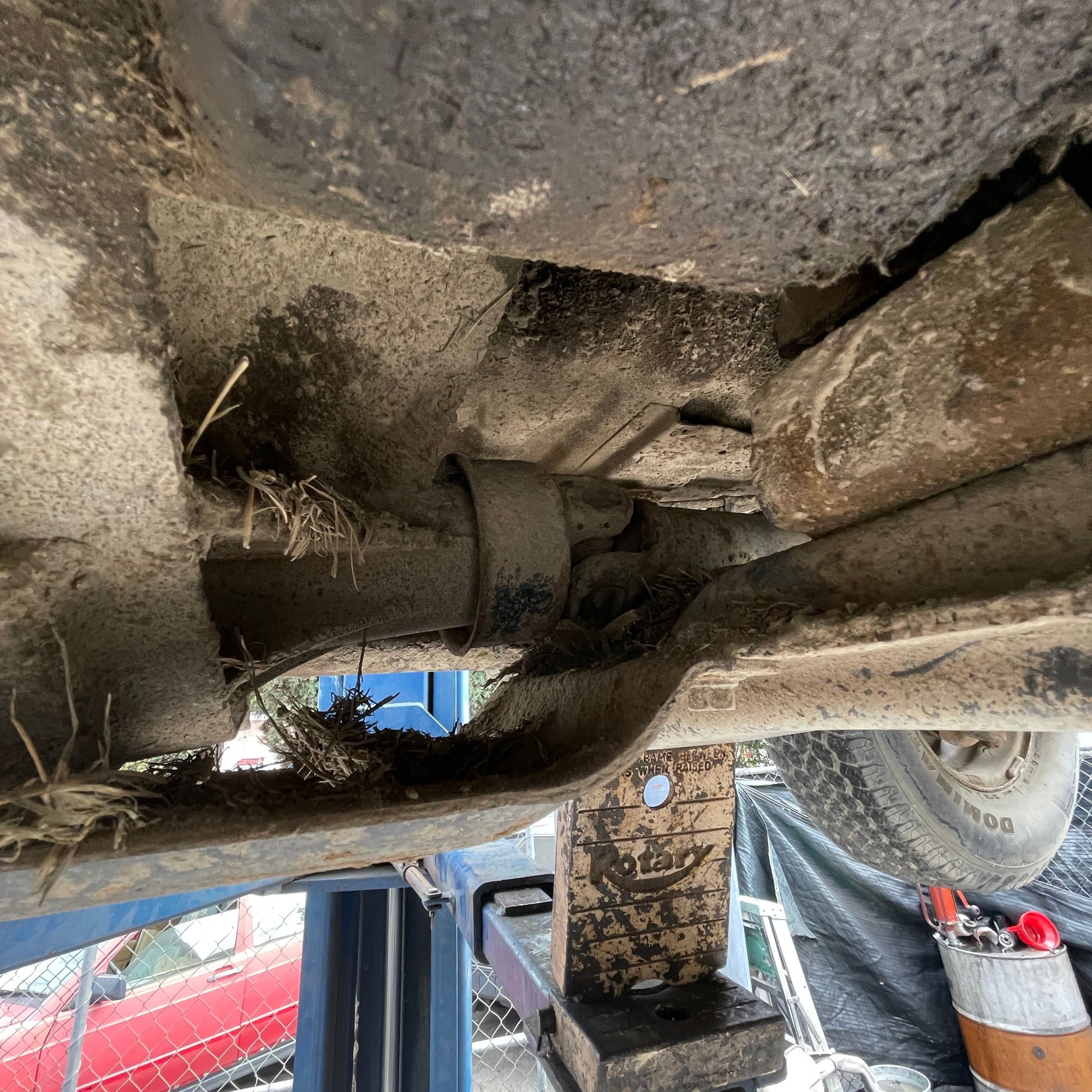

https://cimg0.ibsrv.net/gimg/mitsubi...949ab44e9.jpeg
Theres the second res.

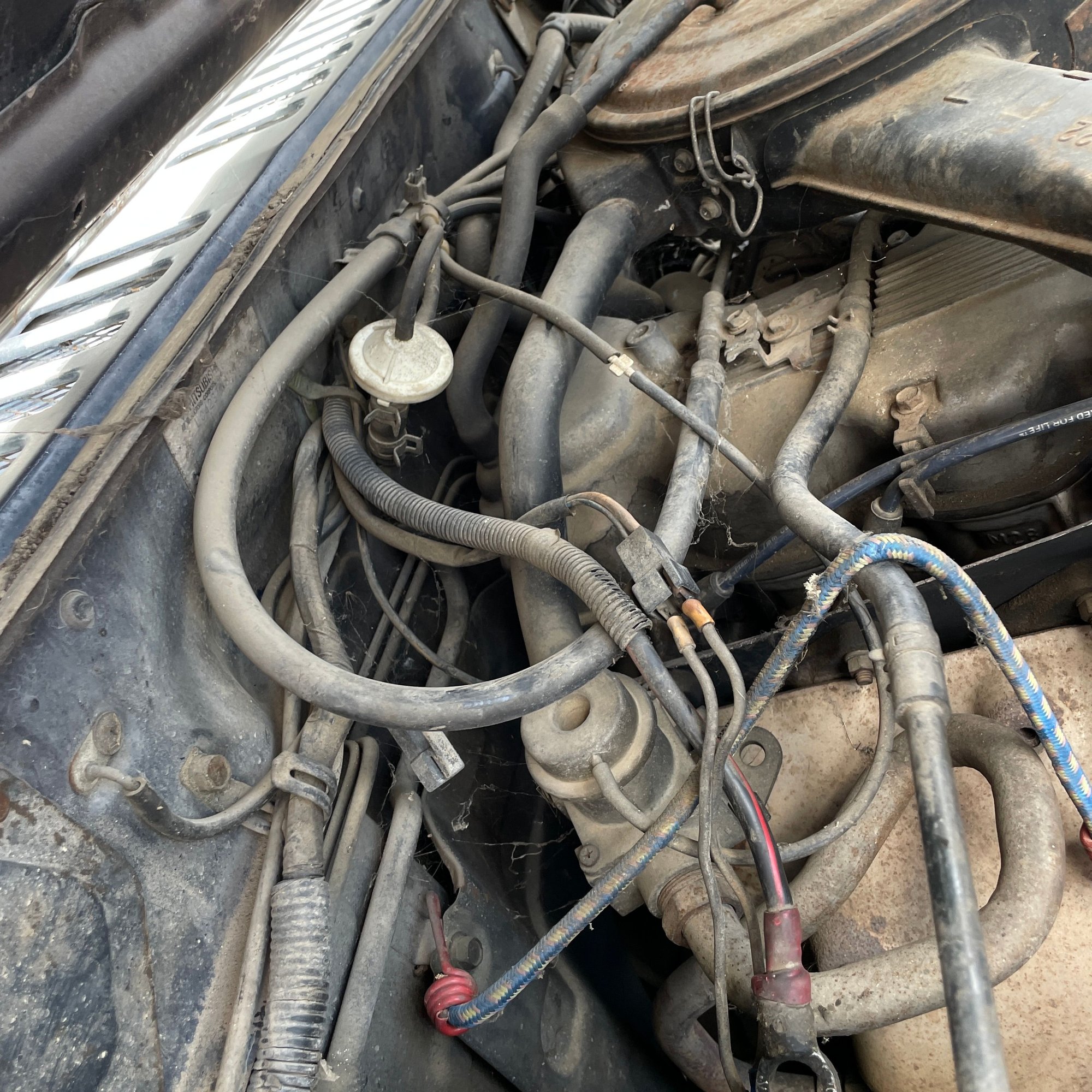

https://cimg8.ibsrv.net/gimg/mitsubi...3fe95204b.jpeg

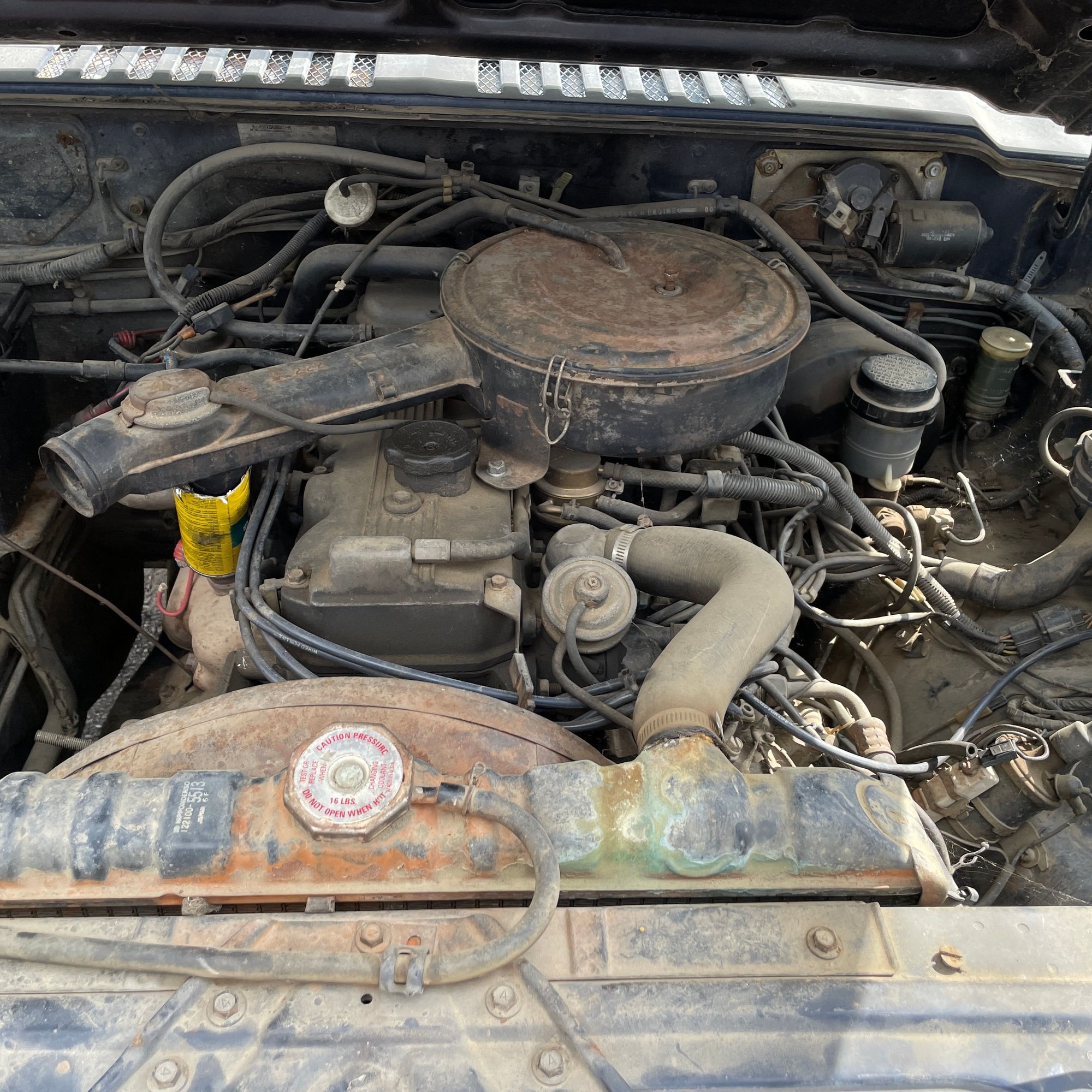

85 montero
https://cimg3.ibsrv.net/gimg/mitsubi...e9a040419.jpeg
85 montero Before

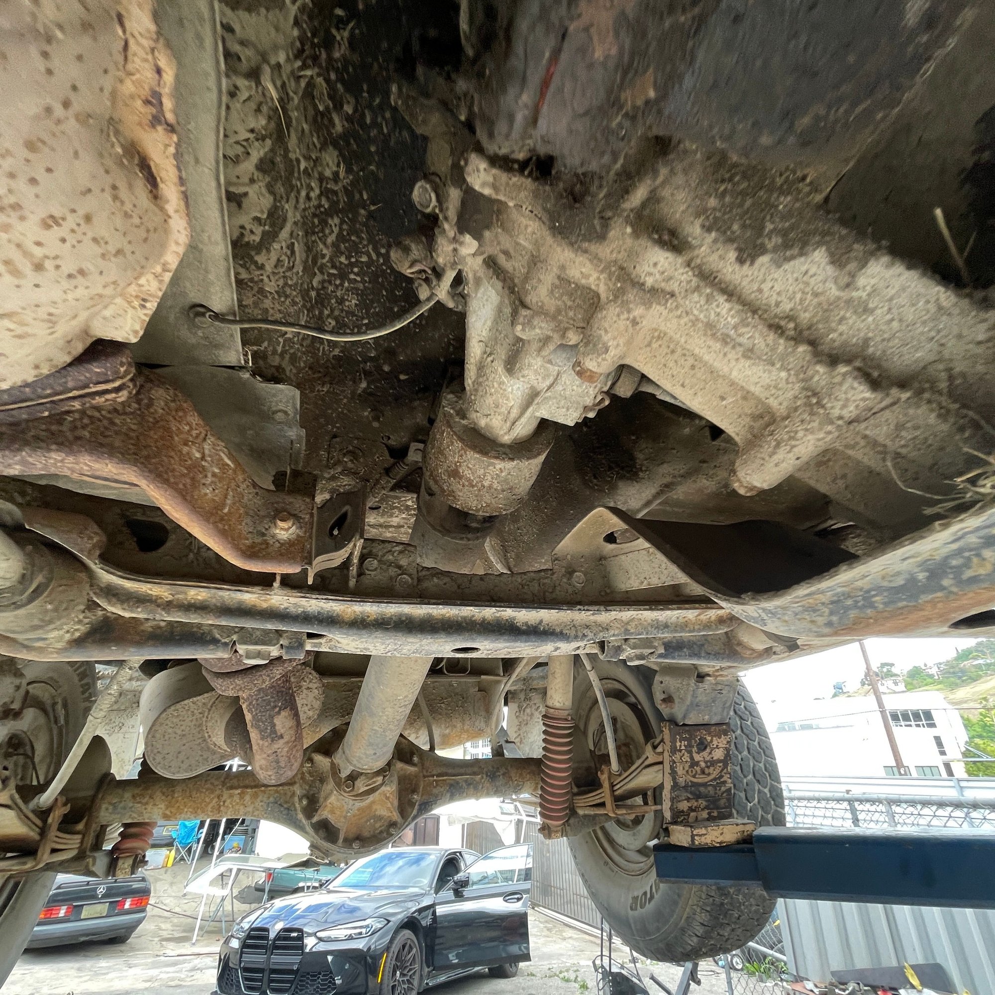

https://cimg9.ibsrv.net/gimg/mitsubi...8a1f3f8a1.jpeg
85 montero Undercarriage before

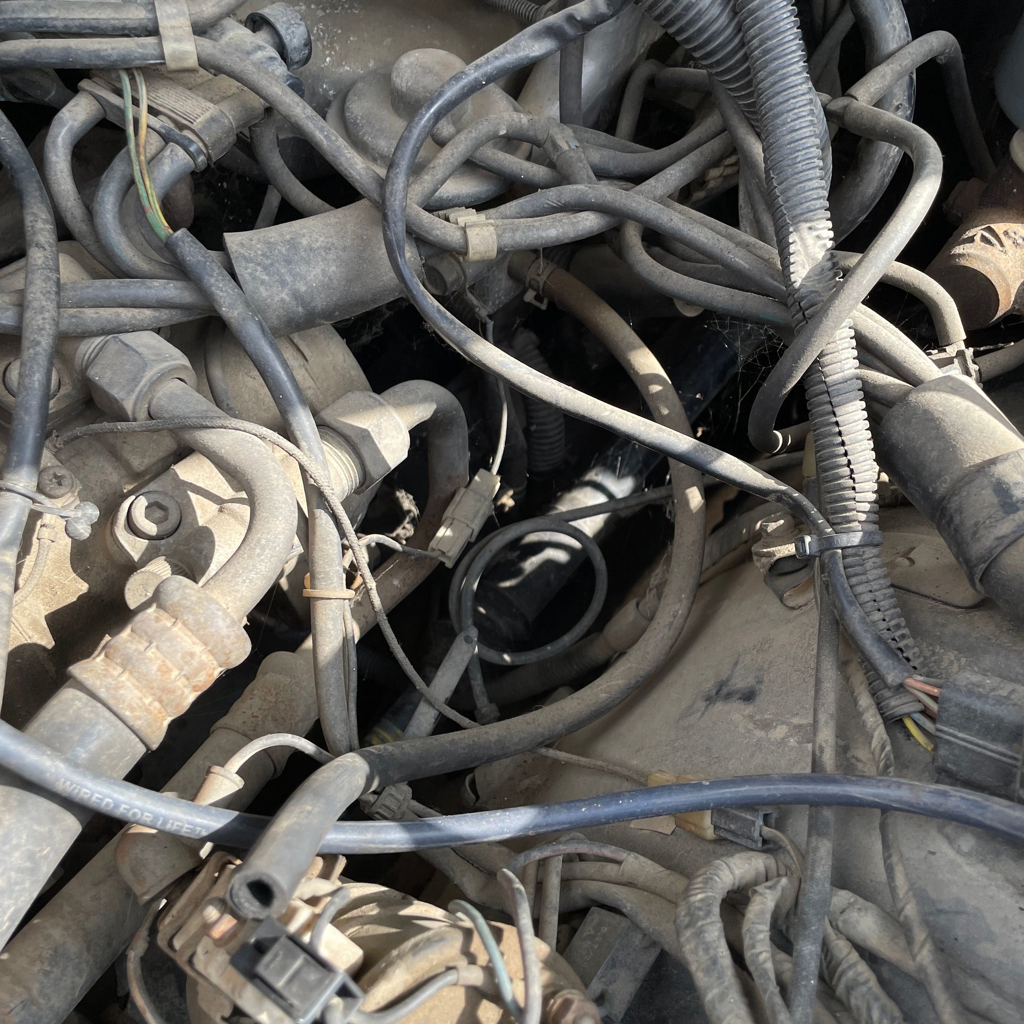

https://cimg7.ibsrv.net/gimg/mitsubi...148d45365.jpeg
85 montero Engine bay

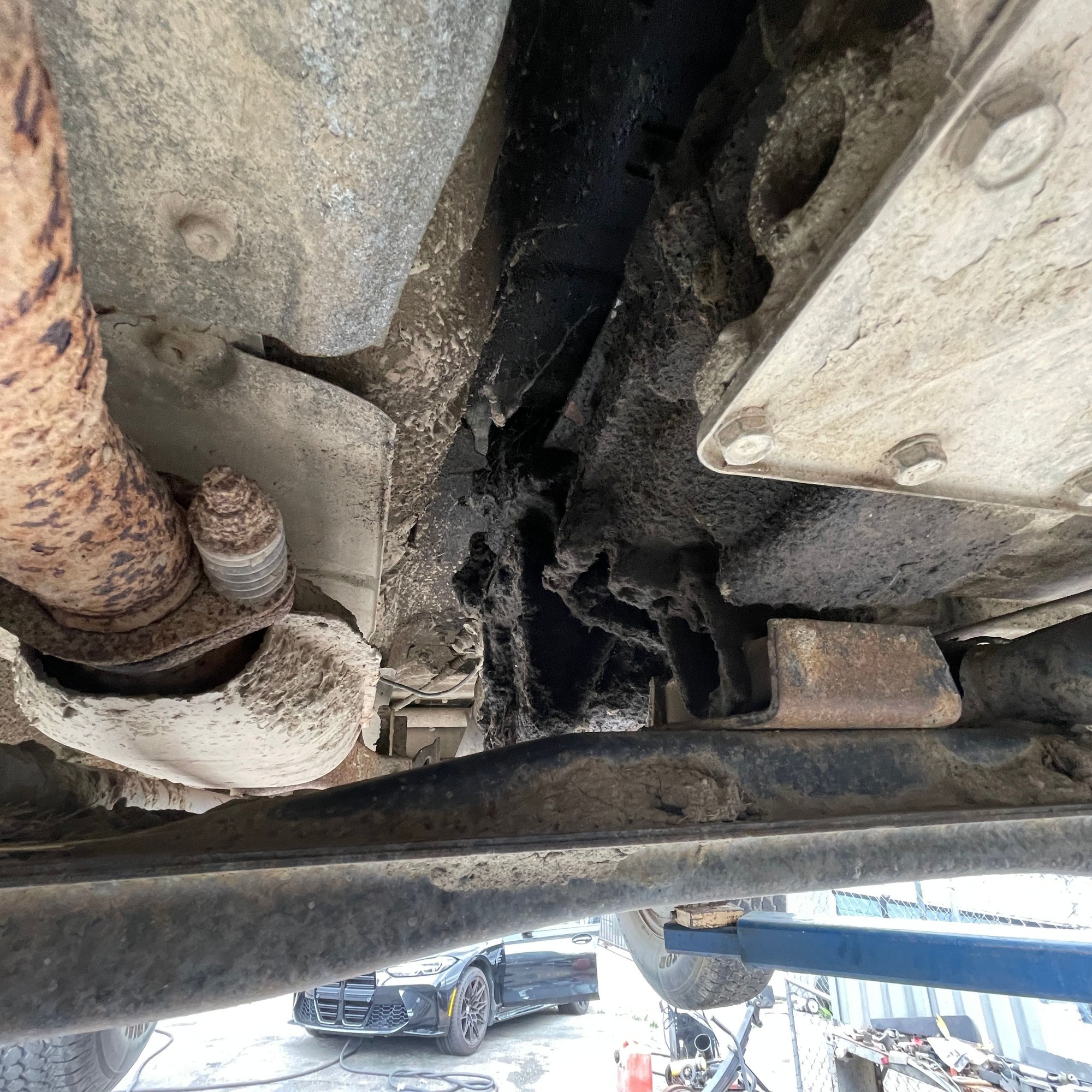

https://cimg3.ibsrv.net/gimg/mitsubi...ac7506ddd.jpeg
85 montero Drivers side where hose was disconnected

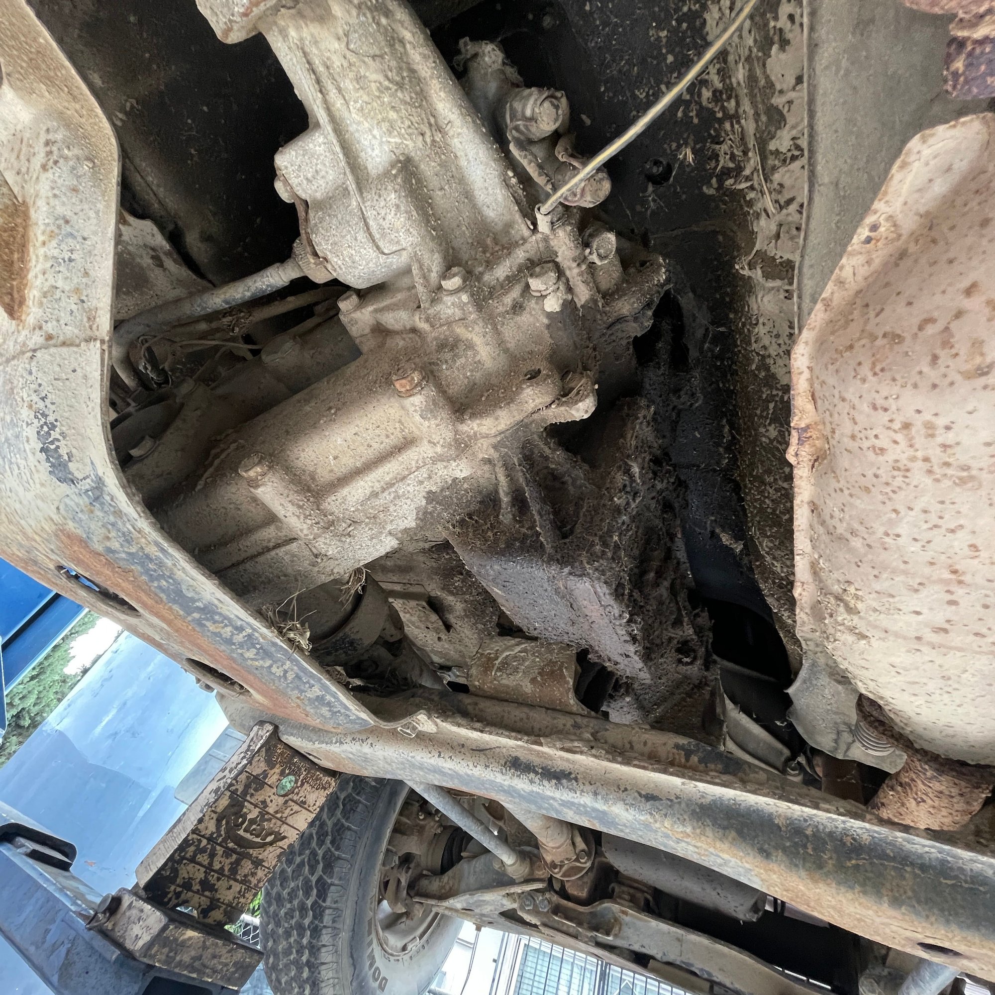

https://cimg9.ibsrv.net/gimg/mitsubi...96ca9a064.jpeg
https://cimg5.ibsrv.net/gimg/mitsubi...d51394771.jpeg
Nest of hoses
