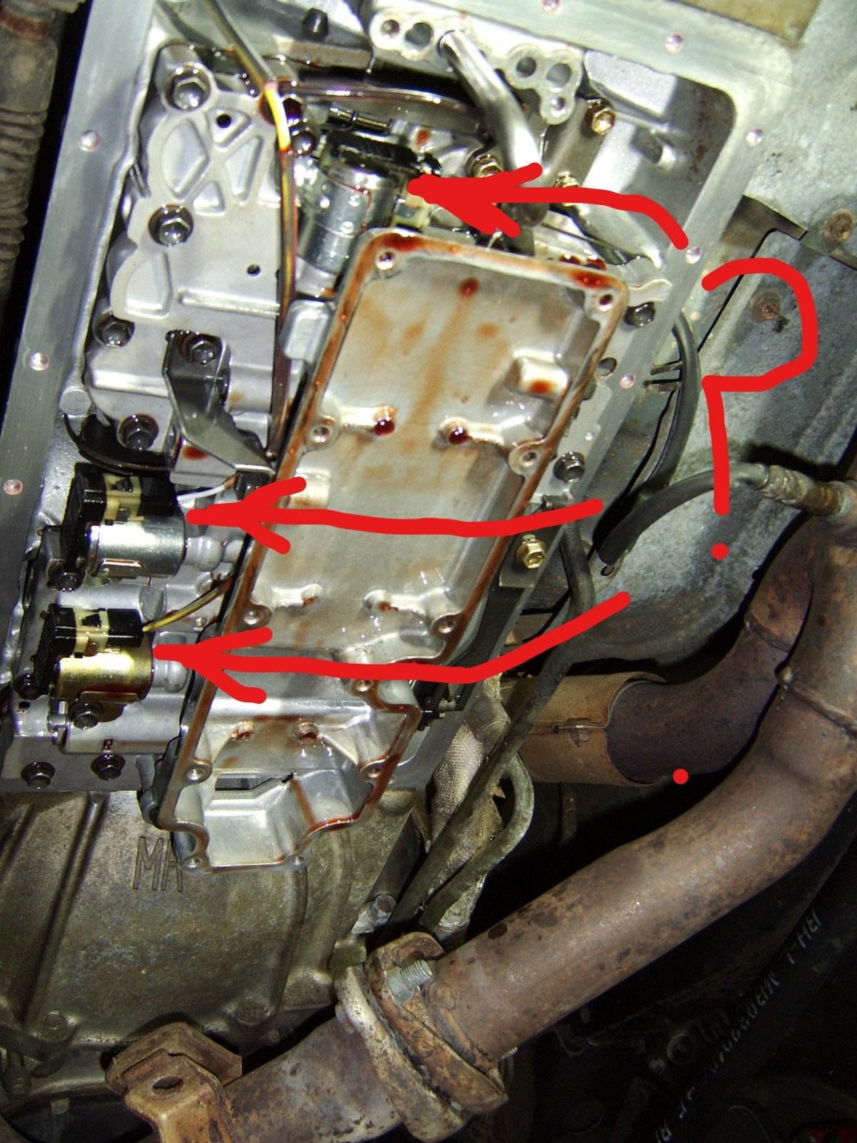

Could it be one of those 3 sensors inside the tranny? See pic below:
(I took pic last year when servicing the tranny.....and I never replaced those 3 switches/sensors)
I just did a complete tranny fluid/filter change about 2000 miles ago, and it has been working perfectly. I am baffled. Help....................................

Anyhow, you got another puzzle on your hands. It is possible to have a bad solenoid, but question, is why? and which one? I would hold off on the urge to pull the pan and start swapping solenoids. First, confirm and isolate the issue. Check fluid level and condition, then run transmission pressure checks in all gears. There is a test port in the tranny. Plug transmission pressure gauge in there and run the tests (you have to find test specs and results interpretation table for your transmission). Then you will know if it is a pressure control solenoid or 2-d gear solenoid or something else that had failed. Then proceed from there. That is what I did with my daughter's car, when it lost transmission.
