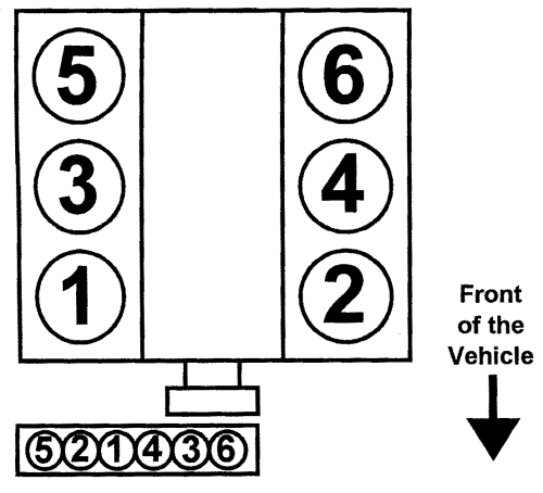

I know it sounds ridiculous but I have to ask. Have you verified the plugs are connected to the correct terminals on the coil packs? The cylinder numbers should be cast onto the intake plenum right behind the coil packs and I also uploaded a picture of the cylinder fire order just in case. Unless you have another one laying around, I would also take a look into getting a cheapo junkyard ignition control module and slap it on there to see if that resolves the issue. Although I haven't had the opportunity to work on a 95 model, I'm fairly certain the TPS has to be calibrated. I googled it and came up with this guide to calibrating the TPS for the 95 Montero w/3.0L as the 3.5 uses the more modern setup introduced in 96. There is also the remote possibility you could have a bad spark plug cable(s) that is shorting to ground or not making connection. Also probable to have a bad coil pack out of the box, try swapping them out one by one and testing to see if the issue is resolved.
Just a few ideas off the top of my head.
