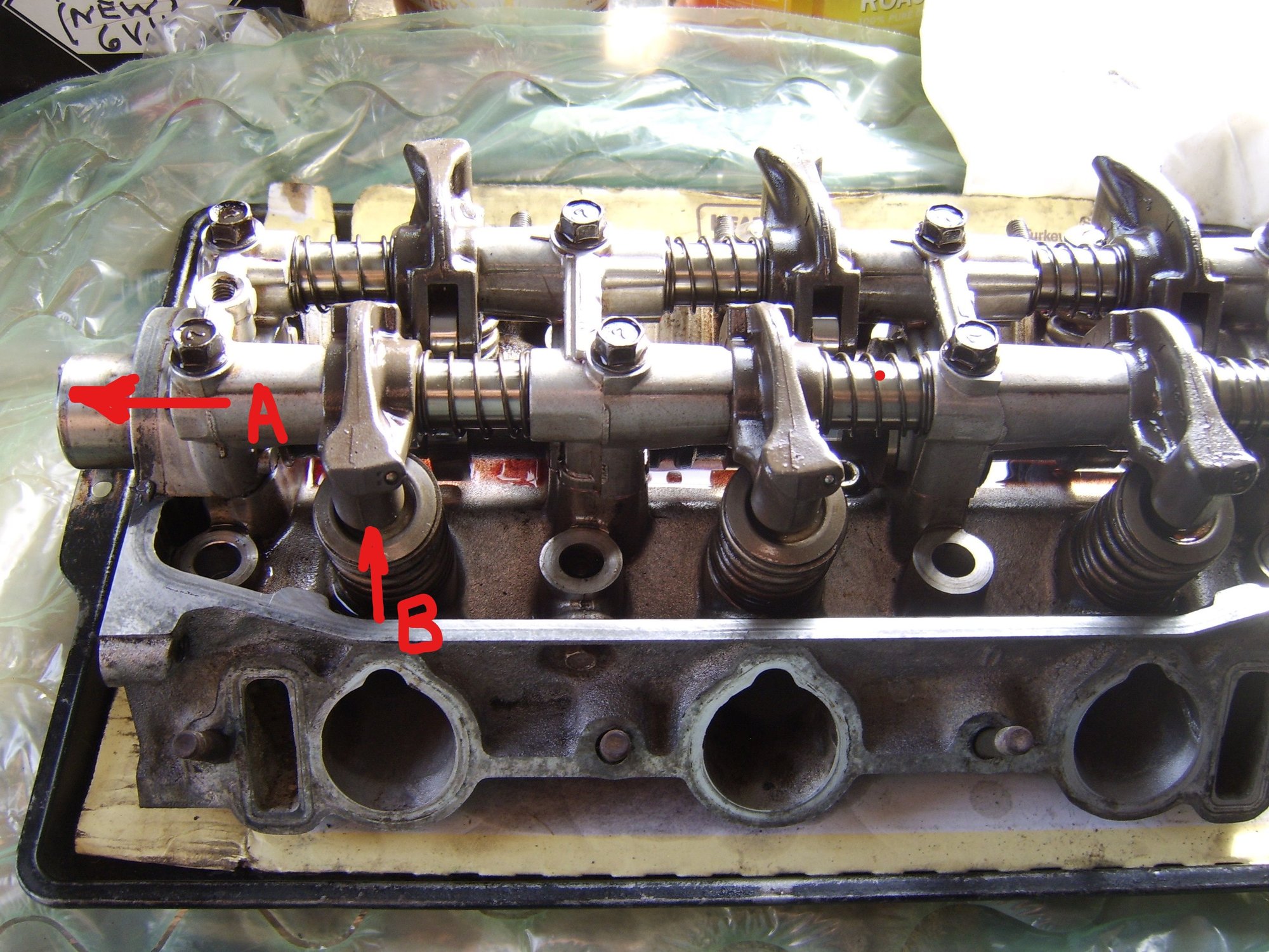

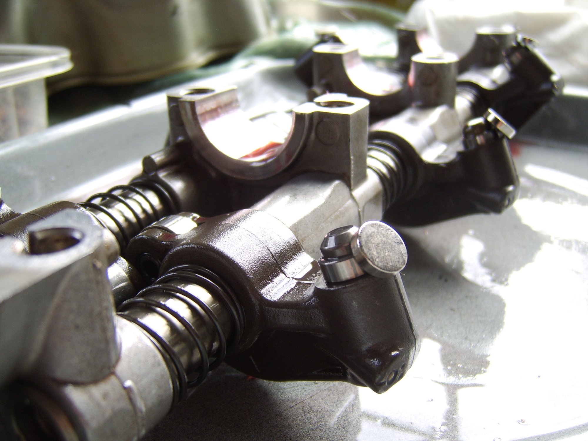

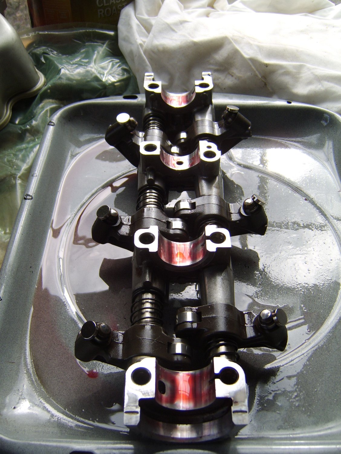

Here is a pic of my 94 Monty LS just to show what I am referring to:
You can see the small dome-shaped lifters with magnets on each one (just my attempt to hold them in place as I flipped over the rockers to install on the camshaft).
In this pic, I have the "A" marking the cam shaft and the direction it would go as it "popped out/moved forward" as you mentioned. "B" is the location of one of the lifters. Would it be possible for a lifter to fall loose from its slot as the cam popped forward? Looking at the pictures, I dont see how that would be possible unless there were alot of loose bolts holding the camshaft/lobes in place.
So, now I am wondering if you meant to say it "popped forward or moved clockwise or counter clockwise in its rotation"?
However, it could be just lack of oil in one of the lifters, and it should "pump up" as you run the engine and the tapping noise will go away.
Monty I'm guessing it is the latter of the two, as I I too don't see how it would be possible to move the camshaft in the A direction with all cam caps installed. If they weren't and it allowed it to slide forward enough to drop a lifter I would expect after moving it back, timing the engine and starting it. It would be very loud and immediately there would be a catastrophic failure. It wouldn't run.
