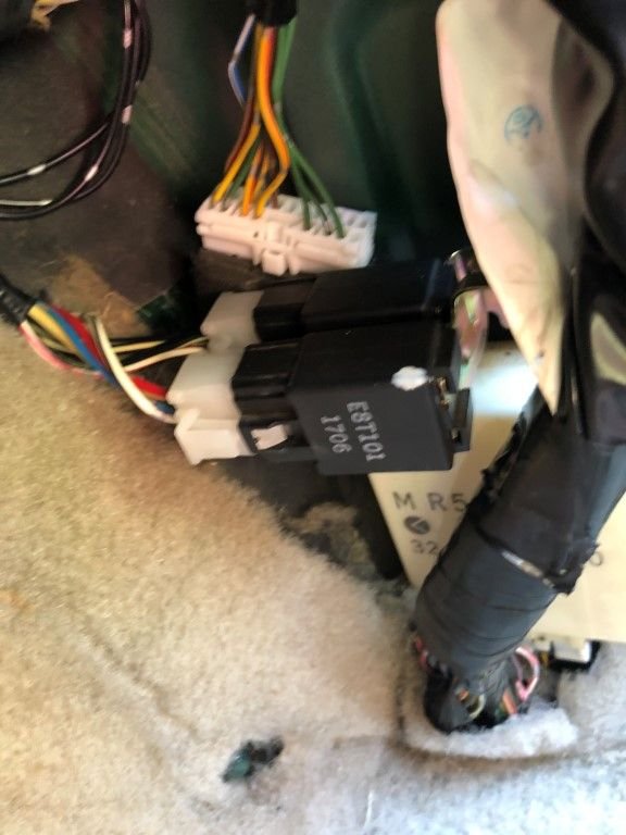

I replaced the fuel filter yesterday. The details in the link from Post 9 were spot on for my 2002 Montero Sport with 3.5L. I disconnected the fuel pump relay and ran engine till it quit to depressurize the fuel system. The relay is located behind the right passenger kick panel and is the relay closest to the body.

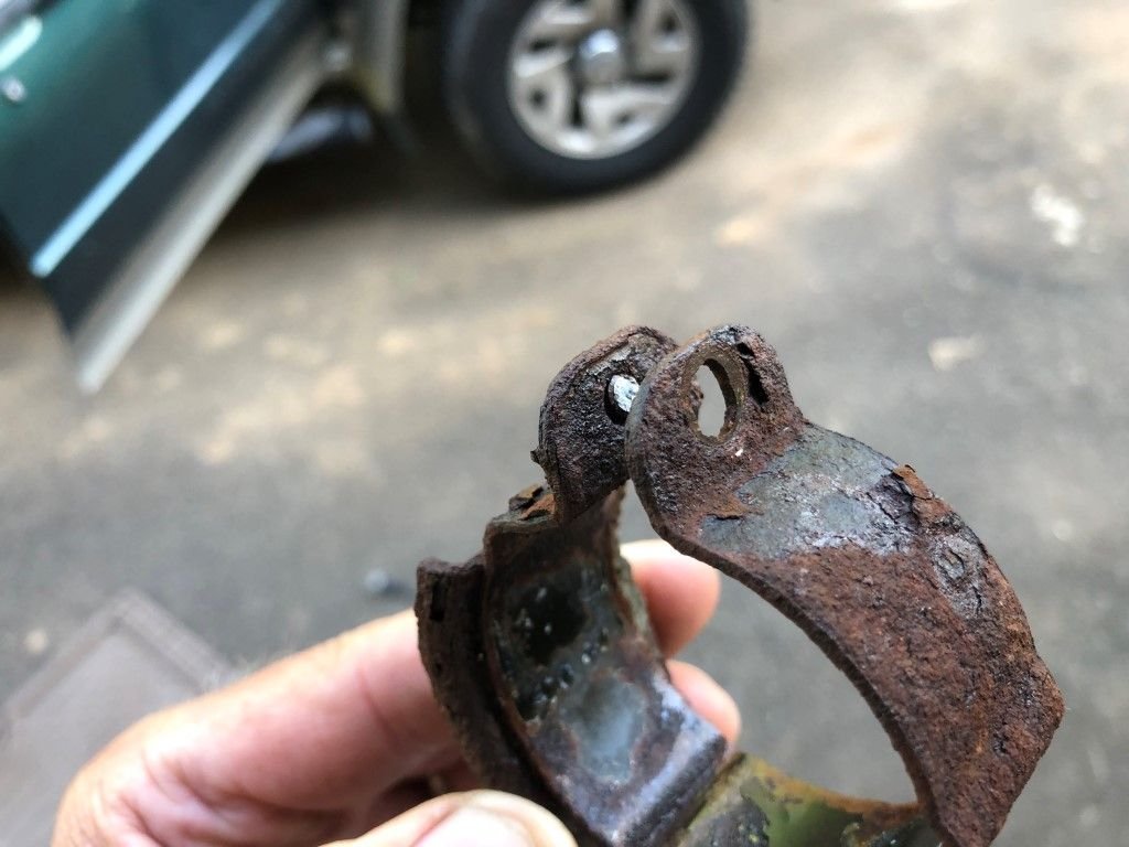

The band portion of the bracket has a welded nut. My bolt broke so I blasted the bracket, ground the failed nut off, welded a new nut on, and painted the bracket.
