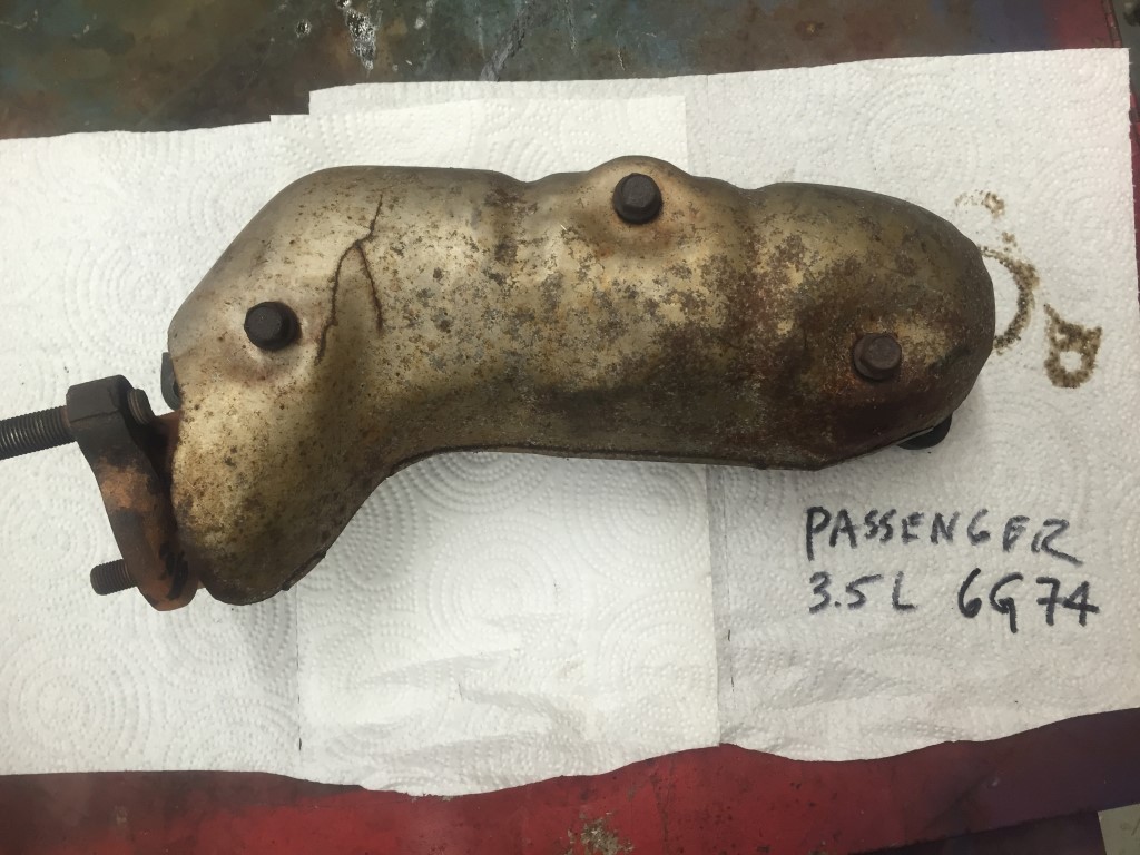

Well it looks like I get to unfortunately join this exclusive club as well!
Passenger side exhaust manifold is cracked between cylinders 3&5.
The pictures from this place show manifolds with the same "RS3" casting number as mine. I will call them this week to discuss
Mitsubishi Montero Sport Right Exhaust Manifold 3.0L 3.5L MR450980 ,
Several Ebay sellers offer similar product at a cheaper price but when you zoom in on the pictures, the casting number boss say "Made in China".
Exhaust Manifold New RH Mitsubishi Montero Montero Sport Montero Sport 95 03 | eBay
Attached Thumbnails Exhaust manifolds-passenger-exhaust-manifold-2002-montero-sport-3.5l-6g74.jpg   Exhaust manifolds-cracked-passenger-exhaust-manifold-2002-montero-sport-3.5l-6g74-150k-miles.jpg   Exhaust manifolds-passenger-exhaust-manifold.jpg   Exhaust manifolds-passenger-exhaust-manifold-made-china.jpg

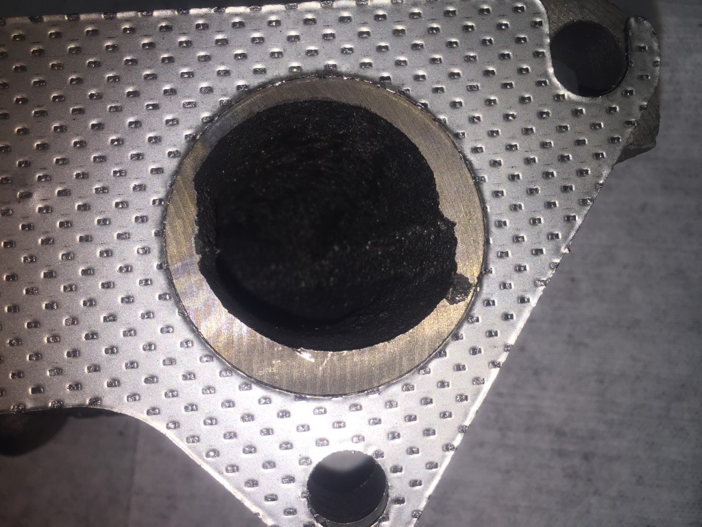

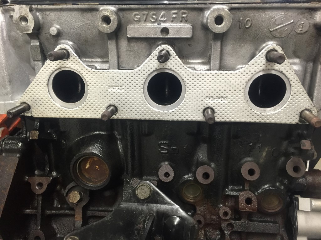

I have purchased a Made in China passenger manifold off Ebay for $59. Attached are pictures comparing the cracked OEM manifold with the China one. The China casting is rough but appears functional. The ports are not as round as the OEM one as evidenced by placing a gasket on the surfaces. Not shown, but the heat shield bolts on fine.
Initially I was concerned regarding the oval and jagged ports, but after comparing the cylinder head ports to the gasket, I think it will be OK as the gasket port is at least 3/16" radially larger than the head port. If this were a hot rod, then I might be a little more concerned.
The pictures were taken using the FelPro gasket but I have since purchased OEM metal gaskets part number MR281721.
