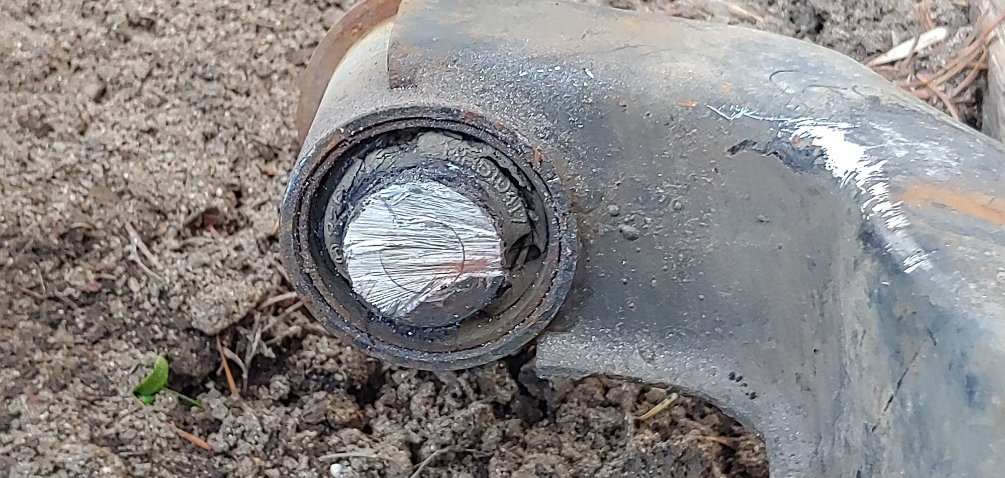

The weather finally got a tiny bit better and I had a chance to work on replacing my front lower control arms. I have to say - getting old ones off was a beast of a job. Two of the adjusting bolts have seized up inside of the bushings and would not come out no matter what. I tried to use heat, persuasion (big hammer...) and they would not budge. In the end I had to cut out those bolts on each side of the bushing in order to remove control arm. Those bolts are BIG and almost feels like they are somewhat hardened. I had to make 4 total cuts (2 ends on two bolts) and I went through 8 reciprocating blades. I'm very glad two other bolts came out without having to cut them.
It definitely helps to remove the wheel knuckle completely to get better access to a better cutting angle.
As you can see the bushings are gone, but there is not much rust on those original arms after 259k
