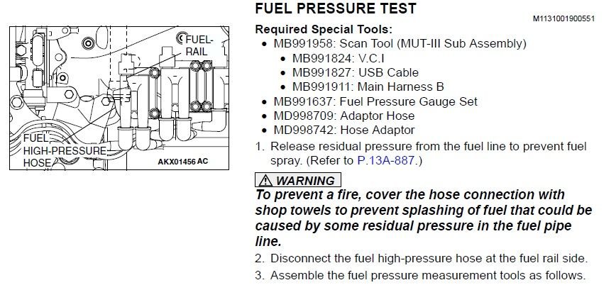

How do you do a fuel pressure test on a Montero sprt 3.5? Theres no part on fuel rail. Need to know what I need or kit to get

Excerpts from manual attached.
Search for MD998709 and MD998742
https://mitsubishi.service-solutions...E-HOSE-ADAPTER
Old Sep 12, 2019 | 09:56 AM
You need fuel pressure test adapter:
https://mitsubishi.service-solutions...T-ADAPTER?c=13
