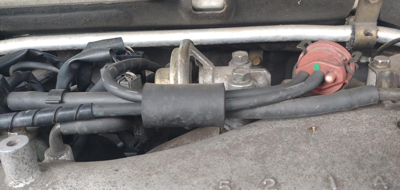

Also, what the heck is this line used for. I took it off and the plastic piece on the line is completely hollow/empty.

As far as the plastic tube is concerned, here is a picture of where it resides:
Spoiler
Weird vacuum line

First is the easier part - mystery rubber ring. I believe that vacuum hose is for feeding vacuum to purge solenoid. The rubber ring is (was) used to keep two additional vacuum lines (EGR valve feed and some other one nearby)together and to prevent them from rubbing on the intake.

On another note, interesting to know that plastic piece is just used to keep them rubbing together. Kinda odd way of doing it I think. I guess I'll have to keep looking for other reasons my MPGs have tanked so hard.
