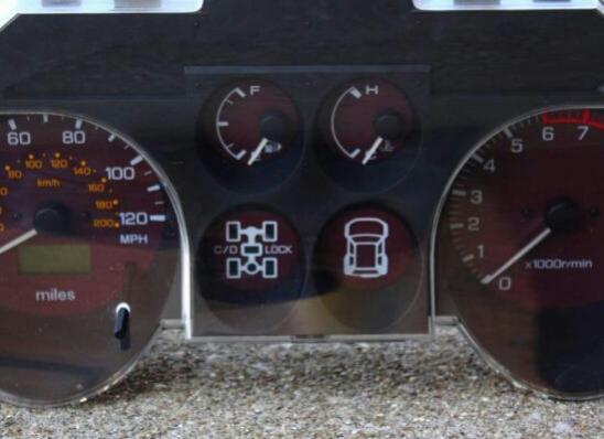

Old Apr 29, 2014 | 10:15 PM
user 27474884's Avatar
Joined: Apr 2014
Posts: 168
Does your instrument cluster say cd lock like this one? And please if im wrong let me know cause you own one and im only gathering info to purchase. But to my understanding cd lock means diff lock and your t. Case shifter should have 2h 4h 4hlc 4llc. The 4hlc and 4llc should lock the transfer case and send a 50/50 split power to the front and rear diff. Is this not the case on the limited?
