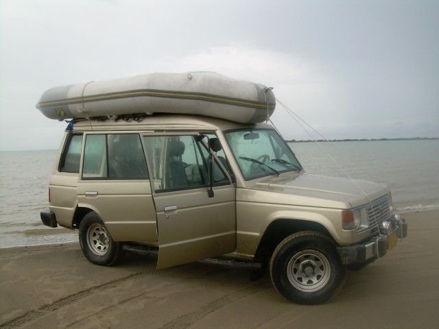

in 2006
in 2006

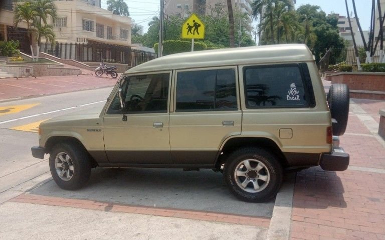

Today
Today
looks like this today
