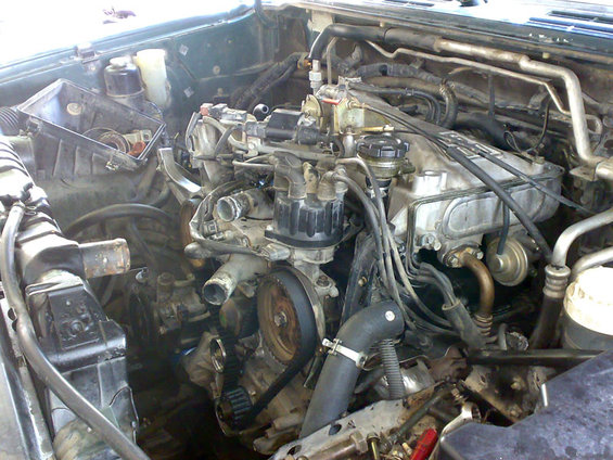

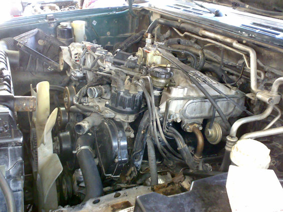

Found a copy of the post on my hard disk:
I would recommend draining the block, which is one thing I did not do.

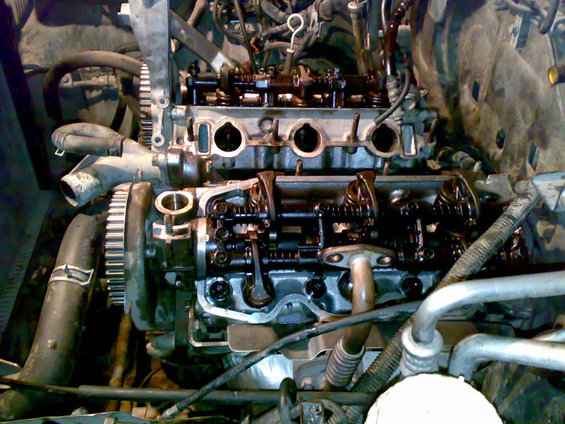

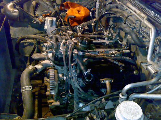

Couple of pictures putting everything back together:
And my list of items that I replaced, in case you find it useful:
- Intake Valves [6] (Part Number: Beck/Arnley 0213322)
- Exhaust Valves [6] (Part Number: Beck/Arnley 0213318)
- Intake Valve Guides [6] (Part Number: Beck/Arnley 0220277)
- Exhaust Valve Guides [6] (Part Number: Beck/Arnley 0220285)
- Gasket Overhaul Kit (Part Number: MD997517)
- Crankshaft Sprocket (Part Number: MD100568)
- Injector Insulators (Part Numbers: MD087060, MD604693, MD604688)
- PCV Valve (Part Number: MD104723)
- Timing Belt (Part Number: MD111427)
- Timing Belt Tensioner (Part Number: Beck/Arnley 0241193)
- Serpentine Belt (Part Number: MD187462)
- Power Steering Belt (Part Number: MD185960)
- AC Compressor Belt (Part Number: MB813344)
- OEM NGK BP5ES Spark Plugs (Part Number: MS851182)
- Thermostat (Part Number: MD972905)
- Radiator Cap (Part Number: MB660735)
- Upper Radiator Hose (Part Number: MB538803)
- Lower Radiator Hose (Part Number: MB538804)
- Heater Hose Kit (Part Number: MB831061)
- Engine Mounts (Part Number: MB436331) [x2]
Might want to run a decent conventional with a quart of Marvel Mystery Oil mixed in for 5,000-6,000 miles to clean up a bit after the head's been open.
