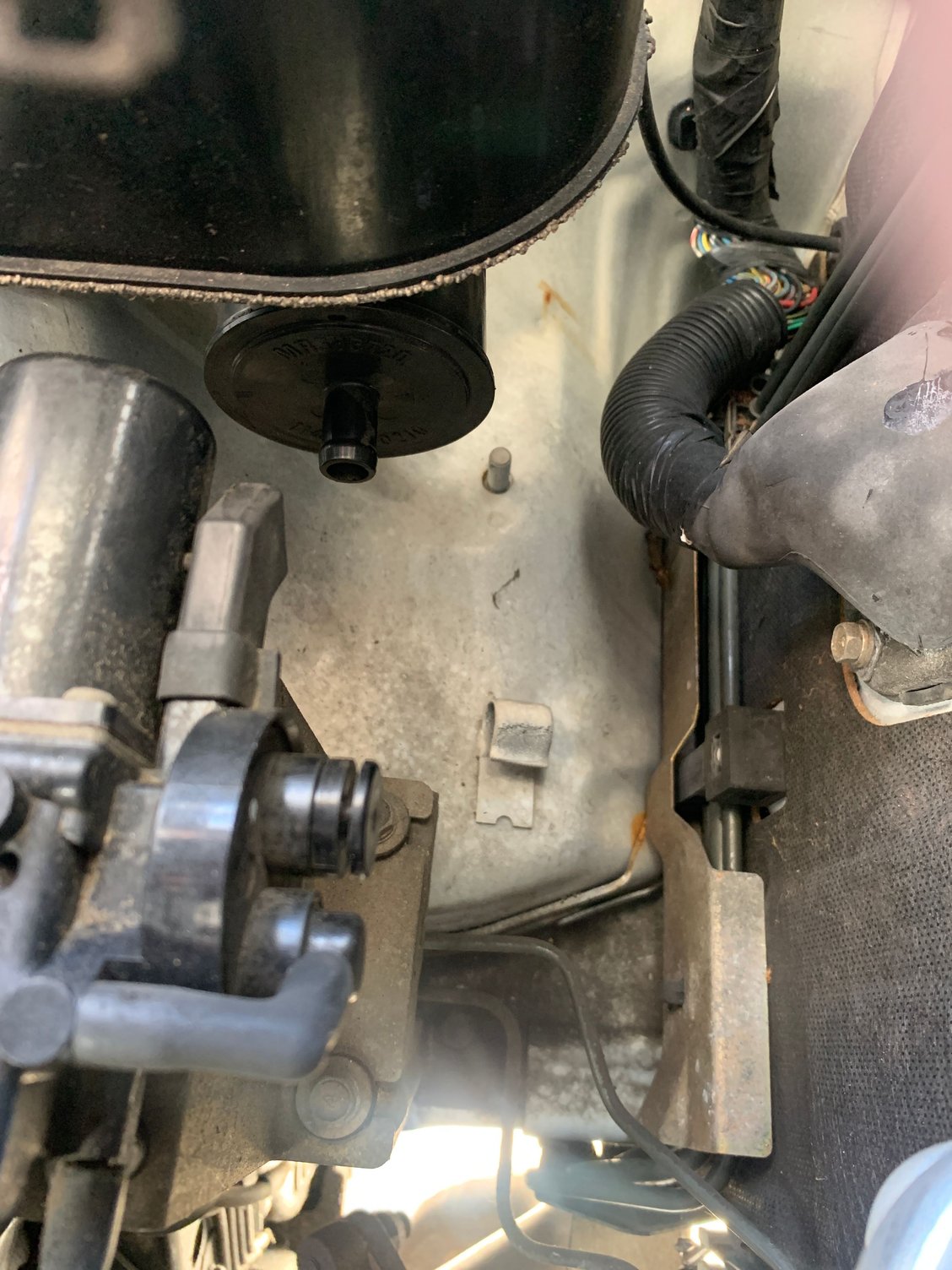

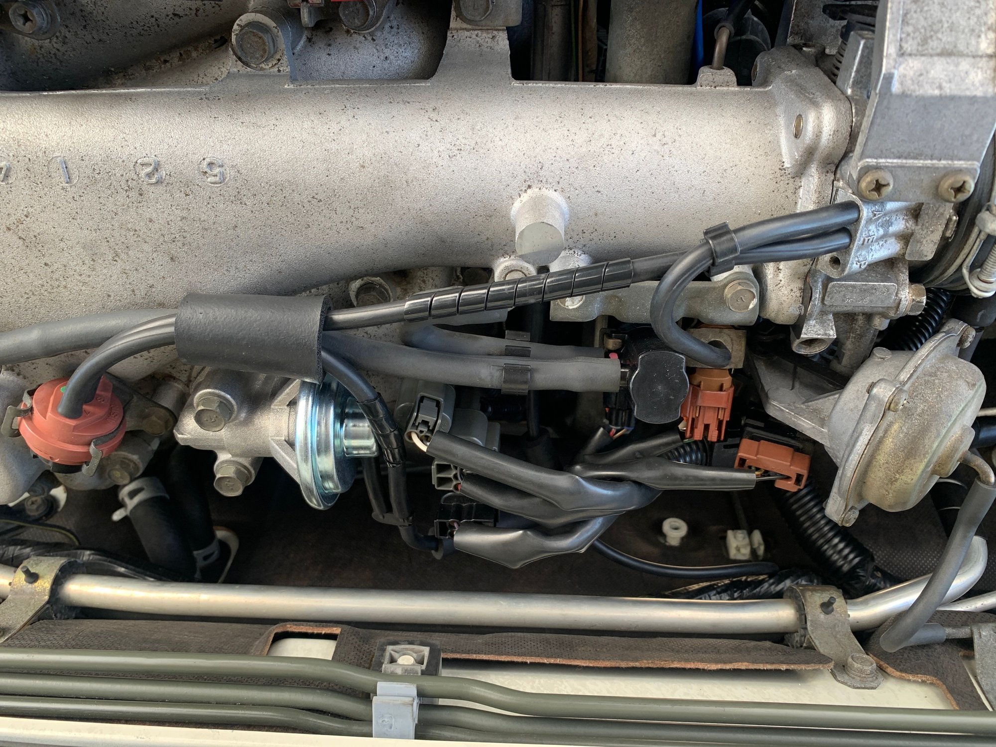

Found one vacuum hose not connected, it didn’t really fox the issue. I purchased replacement vacuum hose because several lines were starting to harden up and had some cracks. Started replacing the line and the problem GOT WORSE! Now it won’t stay running.
Did a scan with OBD II diagnostic tool and still getting a P300 (the other two are fixed). Problems can be numerous, tried to do a vacuum leak test with a nifty smoke machine hooked up to the intake after the sensor and no luck, didn’t see anything. Thoughts! I am going back to the original hoses cause at least it worked BUT, this tells me that it should FOR SURE be a vacuum problem.
Should the canister at the bottom of this photo have a hose on it going to something??
Replaced all the vacuum line you see and cleaned connectors with contact spray cleaner.
