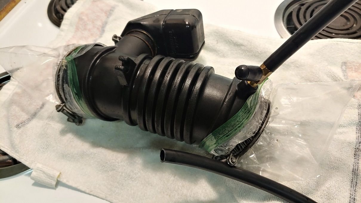

Ok so I got caught by a member of the apartment committee and they apparently were none too happy that I had a potentially explosive container on the property. I had to turn in the propane torch to avoid a hefty fine or getting evicted.
(It's my fault I didn't check the rules first or ask before I did this)
As a result I got creative and did this:
I put sandwich bags over the ends of the intake hose, used the existing clamps to seal it off as best I could, then I attached a hose to the crankcase breather port on the intake hose, I proceeded to pressurize the intake hose and sprayed it down with soapy water much like you would a tire. I saw no leak coming from anywhere after extensive testing. When you pressurize the hose it actually expands so it presents an opportunity for a crack to open up quite easily. A visual pre inspection under a 1200Lumen lamp showed no internal cracks or damage either.
