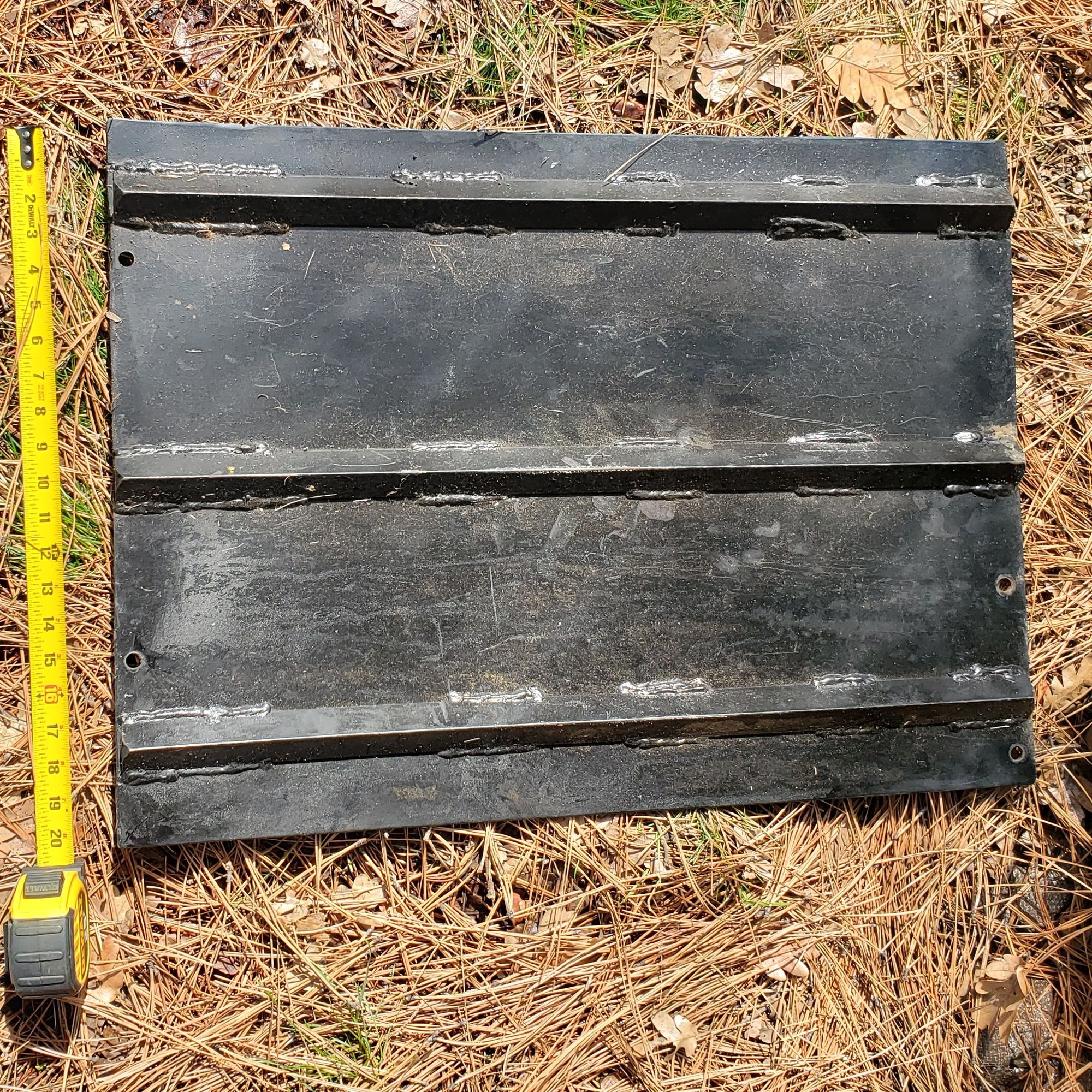

Yep, the... I'm going to call it a 'tank shield' (because in my opinion it's too flimsy to be called a skid plate, lol!!!) is attached to the tank. Those two pieces of shallow channel support the tank, give the flanges some strength. At some point I'm going to make up a proper skid plate out of 3/16" steel with reinforcing ribs to match the trans/xfer case ones.
Ribs are 3/4 x 3/4 x 1/8 angle welded open side to the plate running longitudinally

That of course is the skid plate for the tranny pan!

As Crocodile Dundee would probably say - Now THAT's a skid plate...
