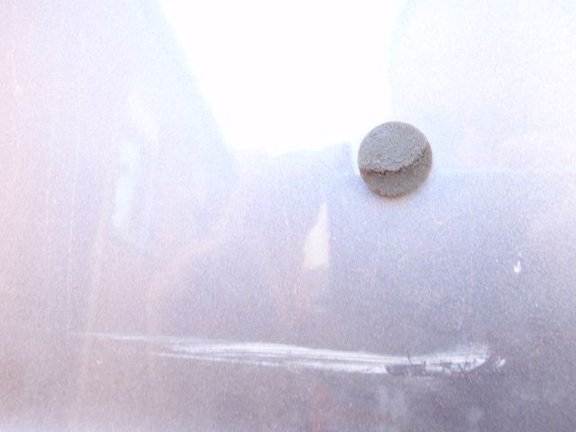

Check your rear plate to see if it is hitting the hatch before you get big scratches!
I ended up having to do the weather stripping option on the rear plate as well. My '09 only uses two screws at the top for the rear plate and the factory installed foam near the bottom of the plate has decayed in less than a year.
I'm disappointed they didn't use a stiff rubber instead of cheap foam dots. The dots location doesn't even make full contact with Ontario plates as the indented letters cause uneven contact with the foam.
This uneven contact caused the plate to hit the hatch and scratch it up pretty bad on the right side. I was able to buff out most of the scratches but there are a few that are pretty deep. They are under the plate though so they got a good coat of wax and that is that.
The plate bottom still sits pretty far from the door - I'd say at least a 1/2" or more - you can use pretty thick weather stripping if you have to buy some.
