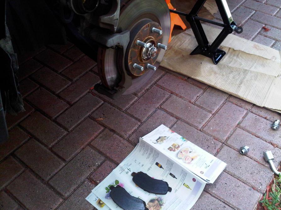

Wait, this is what it looks like with the lower caliper pin removed and the caliper rotated up - doesn't look like the rotor will come off this way.
Or do you mean that I can only remove the caliper bracket's lower bolt and rotate the whole bracket/caliper assembly up?

You need to remove both bolts from the back of the caliper bracket. Then you just take the entire caliper assembly off. Make sure you don't allow it to dangle by the brake lines - tie it to the springs to keep it out of the way.
Then, the rotor can be removed easily - may need tapping off with a hammer as mentioned previously - often it takes quite a few firm taps with a hammer.
