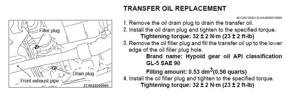

Where is the transfer case drain plug? Do you have to remove anything to get to it?

drain plug is the very bottom of the transfer case. fill hole is towards the rear of the vehicle. Check out attachment. Make sure you can remove the fill plug before draining.
I used Mobile1 75w90 for both tcase and rear diff. Rear diff was more difficult.
