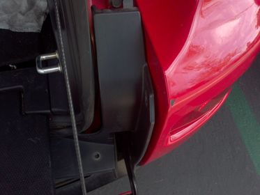

How to replacement rear side marker in Mitsubishi Outlander 2007-2009 - part 3
Attached Thumbnails 2007 Mitsubishi Outlander - where to buy rear side marker replacement?-2012-03-28-13.40.31.jpg   2007 Mitsubishi Outlander - where to buy rear side marker replacement?-2012-03-28-13.40.54.jpg   2007 Mitsubishi Outlander - where to buy rear side marker replacement?-2012-03-28-13.41.05.jpg   2007 Mitsubishi Outlander - where to buy rear side marker replacement?-2012-03-28-13.41.15.jpg   2007 Mitsubishi Outlander - where to buy rear side marker replacement?-2012-03-28-13.41.47.jpg

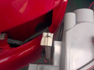

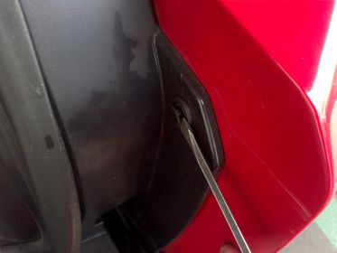

How to replacement rear side marker in Mitsubishi Outlander 2007-2009 - part 4
Attached Thumbnails 2007 Mitsubishi Outlander - where to buy rear side marker replacement?-2012-03-28-13.41.56.jpg   2007 Mitsubishi Outlander - where to buy rear side marker replacement?-2012-03-28-13.42.03.jpg   2007 Mitsubishi Outlander - where to buy rear side marker replacement?-2012-03-28-13.43.16.jpg   2007 Mitsubishi Outlander - where to buy rear side marker replacement?-2012-03-28-13.44.57.jpg   2007 Mitsubishi Outlander - where to buy rear side marker replacement?-2012-03-28-13.49.06.jpg

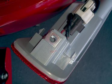

How to replacement rear side marker in Mitsubishi Outlander 2007-2009 - part 5 of 6
Attached Thumbnails 2007 Mitsubishi Outlander - where to buy rear side marker replacement?-2012-03-28-13.49.14.jpg   2007 Mitsubishi Outlander - where to buy rear side marker replacement?-2012-03-28-13.55.22.jpg   2007 Mitsubishi Outlander - where to buy rear side marker replacement?-2012-03-28-13.56.40.jpg   2007 Mitsubishi Outlander - where to buy rear side marker replacement?-2012-03-28-13.57.13.jpg   2007 Mitsubishi Outlander - where to buy rear side marker replacement?-2012-03-28-13.57.30.jpg

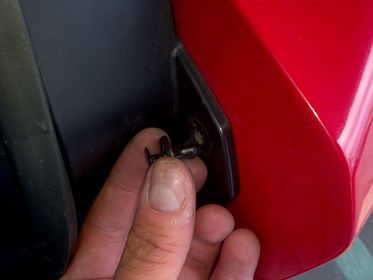

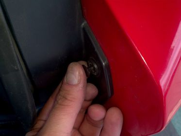

How to replacement rear side marker in Mitsubishi Outlander 2007-2009 - part 6 of 6- final.
Hope it helps.
Attached Thumbnails 2007 Mitsubishi Outlander - where to buy rear side marker replacement?-2012-03-28-13.59.47.jpg   2007 Mitsubishi Outlander - where to buy rear side marker replacement?-2012-03-28-14.00.04.jpg   2007 Mitsubishi Outlander - where to buy rear side marker replacement?-2012-03-28-14.00.18.jpg   2007 Mitsubishi Outlander - where to buy rear side marker replacement?-2012-03-28-14.00.25.jpg   2007 Mitsubishi Outlander - where to buy rear side marker replacement?-2012-03-28-14.00.59.jpg
