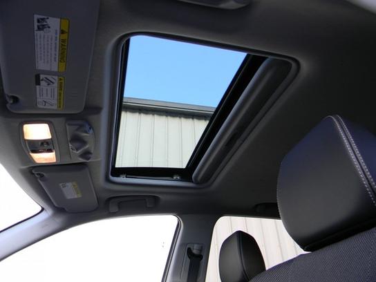

We have a 2010 Outlander XLS. Now that its summer, we have started to notice that if we lock the outlander and leave any of the windows down a little or the sunroof open the alarm will tend to go off some times.
Has anybody else noticed this? It seems that if the windows are up and the sunroof closed we dont have any issues, and it doesn't even have to be a windy day

It's the ultrasonic sensor attached to the headliner in front of the sunroof.
It detect air movement inside the cabin.
