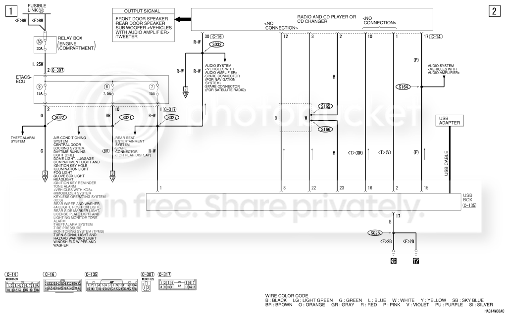

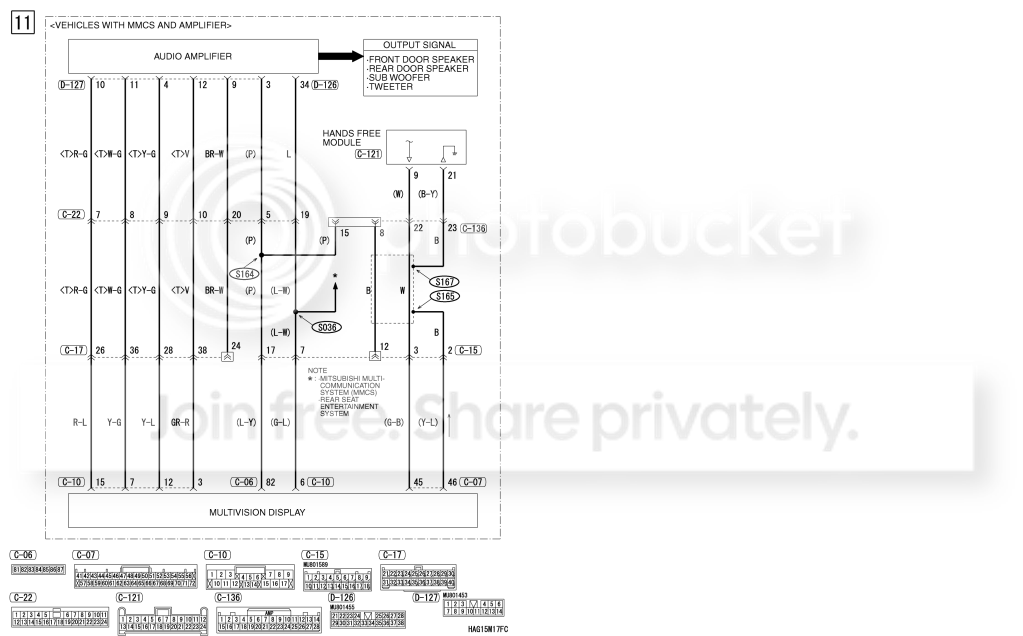

I hope this help. In addition to the Bluetooth module, you need at least a module or connector called USB (see diagram). Definitely, we need to know the part number as the Bluetooth and USB modules and I think the MMCS require firmware upgrade to handle the new functions offered by FUSE system
http://i339.photobucket.com/albums/n...M08AC00USA.png
(USB conector or module)
http://i339.photobucket.com/albums/n...7FC00USA-1.png
(Bluetooth module)

FUSE looks to be very well entrenched into the system, with connections to the Bluetooth module, stereo, and ECU.
According to the service manual for a 2008 Outlander, ETACS ECU connector C-317 pin 1 is simply +12V all the time. So hopefully that means modifying the ECU is not required.
Otherwise, it looks like the USB module should be physically compatible with the radio...so it would plug into the radio. In the worst case, you may need to splice your Satellite radio into the new connector...but unplugging C-14 and losing satellite radio temporarily will be good enough to test it.
I believe connector C-16 pin 30 is the CAN BUS signal, which means that the bluetooth module communicates with the box directly (probably for A2DP or maybe even controlling the USB box).
So I think only Bluetooth may need a firmware upgrade...hopefully not the radio. I don't see a reason why the ETACS ECU would have anything to do with this.
