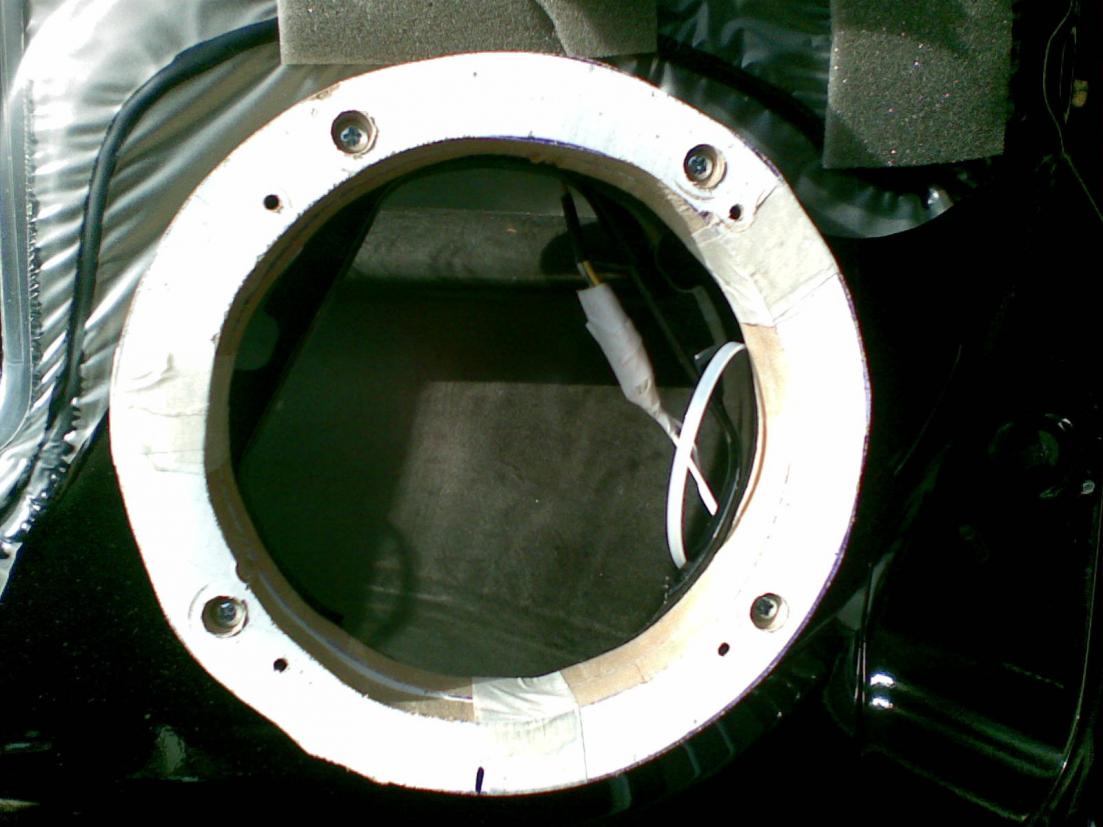

I saw a post or two about replacing the door speakers, but couldn't find one specific answer that I'm looking for. I've removed the rear door panels and twisted off the stock speakers just to have a look. I know a spacer will be required, but what about actual mounting? Do you have to drill your own holes into the door as none appear to exist since the originals twist in. Thanks!

Not fitted new speakers to my outlander, but have to loads of other cars. I always make mounting rings out of MDF and then you screw these into the inner metal layer of your door - don't worry, you wont do it any harm! Sorry the photos aren't great, but should give you an idea of what I mean. This will give you a really nice fit with no rattles. Ignore the bits of white tape on the photos - they were just holding the rings together during assembly.
