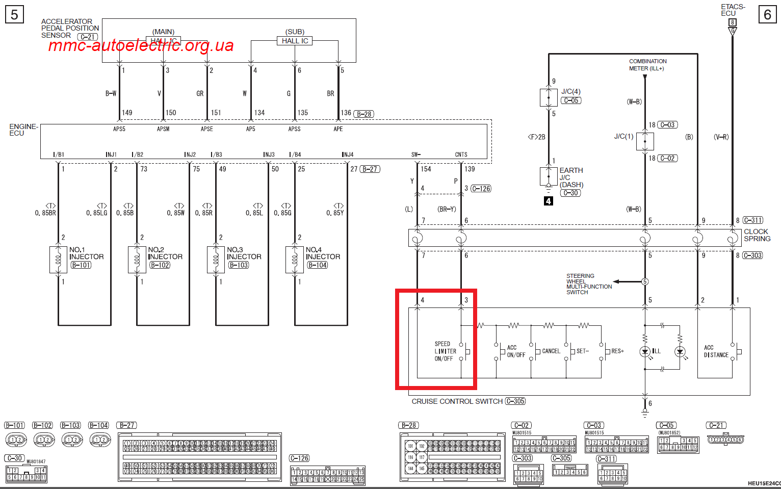

So here is what I found so far regarding the wiring.
According to the EUR Service Manual (the only I found), Diesel motors (4N1) has the button while MIVEC (4J1) doesn't. I didn't find the manual for the 6 cyl MIVEC (my case!).
All cruise control buttons are directly connected to the ENGINE-ECU.
The missing button just connects two wires together (otherwise they would have a resistance).
So I believe:
- there will be no missing hardware apart the button;
- the button itself could be simulated on connectors C-303 or C-311 (or directly on the ECU connector)
- the option must enabled in ETACS (or in the ECU??)
Vadimus, any light?
Both I suppose.
But once again, no one knows if your particular engine ECU supports it.
