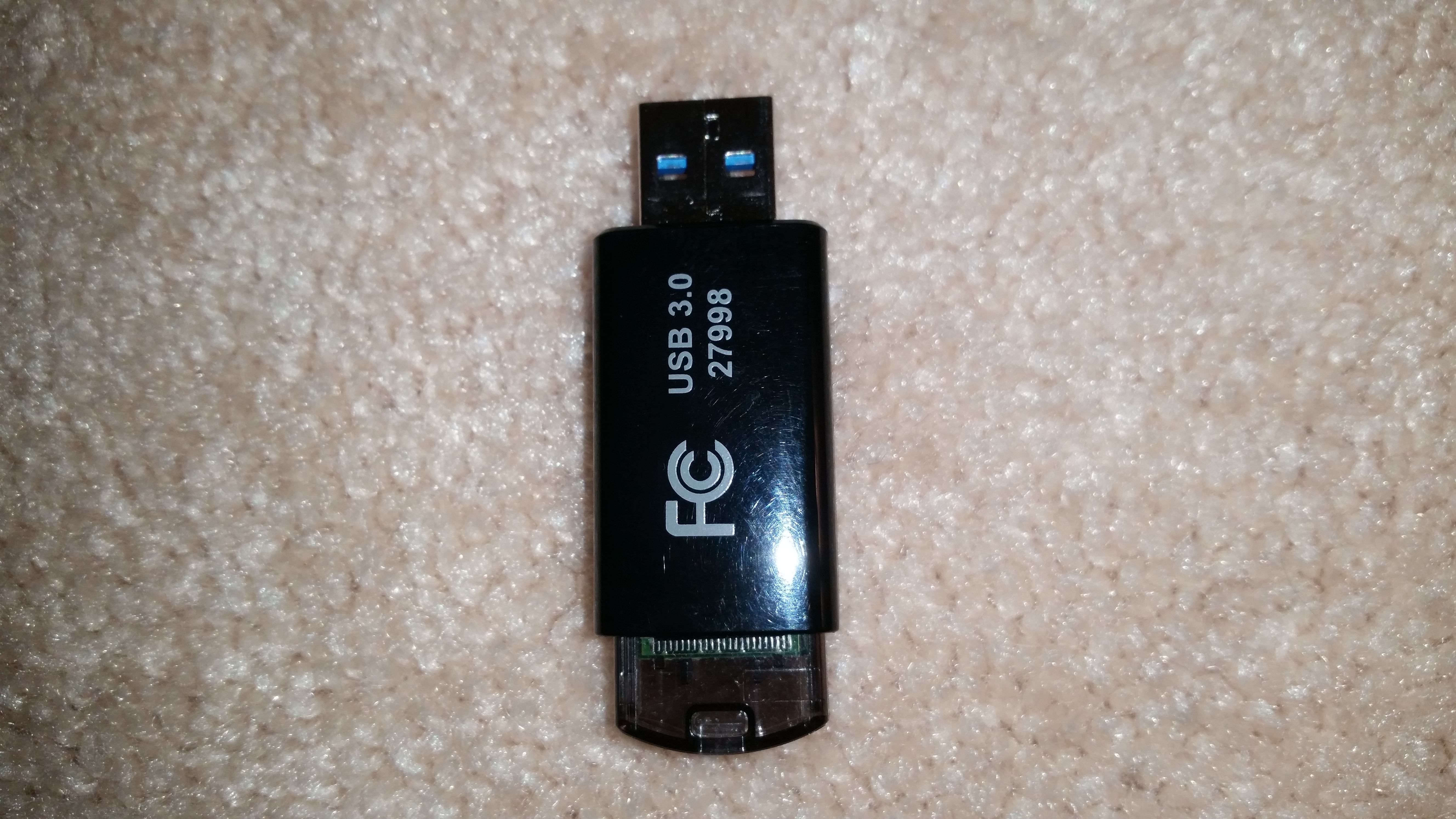

If you're using USB now. Do you think the error from USB? Try Staples 128GB USB 3.0 Flash Drive (or Staples 128GB USB 3.0 Click Drive) I have no issue at all by far. I never loose the settings of what is playing. It will continue play at the last stop. It's not forgotten a specific artist, album or genre.
Attached Thumbnails Annoying bug with LINK system and USB music with 2016 outlander-20160613_024904_1465800870956.jpg   Annoying bug with LINK system and USB music with 2016 outlander-20160613_024925_1465800871218.jpg   Annoying bug with LINK system and USB music with 2016 outlander-20160613_025050_1465800871340.jpg

The usb flash drive on our '16 works as expected. I'm not experiencing those problems of "resetting" where I left off. However, I have tried the ipod thing once and it worked like the usb drive, so I didn't see any album art. I don't recall ever seeing album art, but we primarily use the usb flash drive. You have me curious and now I want to check to see if it works.
Like catacami said, usb drives are often flaky and vary from drive to drive. For reference, I'm using this one:
https://www.amazon.com/Samsung-Flash....0+flash+drive
This one works perfectly and is very low profile so it won't get knocked of or break inadvertently. And it's $11. I know from past experience, brand, size, and formatting matter. Different sizes of flash memory use different standards. I've also successfully used a usb 2.0 8gb cheap generic. Now that I think of it, if your connection to the flash drive is loose, it could be getting disconnected somehow. That's the only time I've seen my usb settings reset is when I remove it and reconnect it. Not sure where the connection is in your model, but mine is in the center console along with a lot of other junk stored in there. If I had one of those big, non-low profile drives, I can see it getting jiggled loose.
