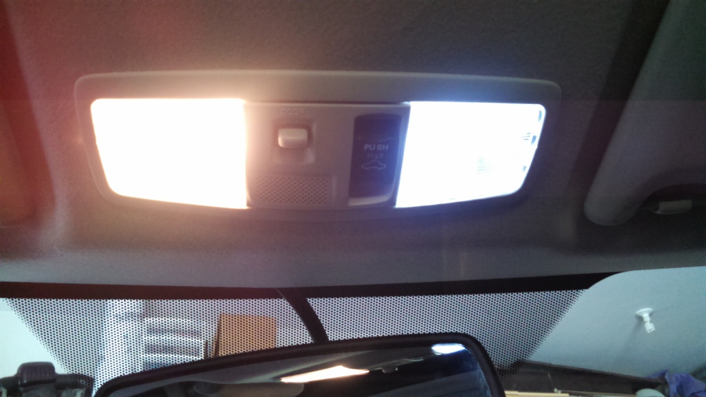

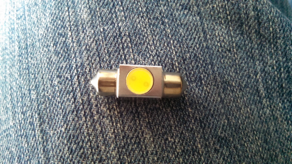

swapped out all dome / map lights to LED...
31mm 1 watt festoon..
comparison...

Was it hard to get the plastic covers off? Did you get blue or white LEDs?

EXTREMELY EASY!! about a 6000k LED
Front lights - entire housing pops out of roof..
2nd row - pop clear lens off
hatch - pop clear lens off

What did you use to pry them open? Did you have instructions? I want to do the same just afraid to damage them.

Small, flat blade screw driver...

Thank-you, we're the bulbs plug and play or did it require wiring?

just normal bulbs.. see 1st pic
