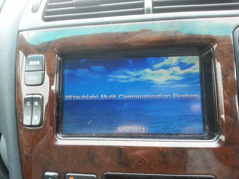

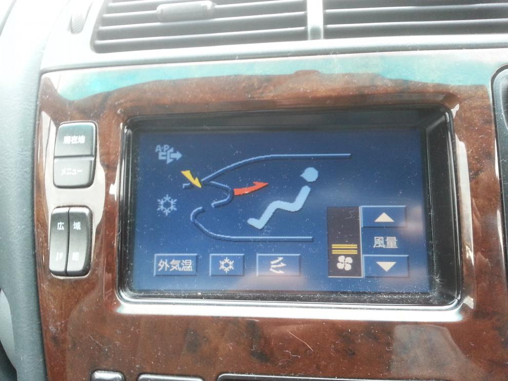

Hi guys as I said before, I have a 2000 diamante with touch screen multi media system I have included pics of it but do not know which model it is I Would like it to be converted to english if possible
many thanks
Attached Thumbnails Conversion of J-01 MMCS into English-20140621_102311.jpg   Conversion of J-01 MMCS into English-20140621_102323.jpg
