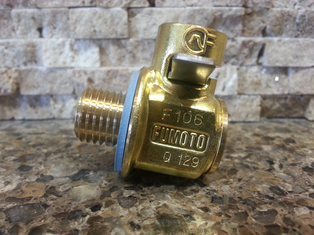

Little surprise in the mail this weekend!!

I have used FUMOTO oil drain valves on all my cars since 1987. They are a great investment and make oil changes very clean and easy. You now can get them with nipples to attach a poly hose to drain right into a basin or battle. Well made ball valve and worth the $$$.

Argh. Just tried to install the Fumoto on my 2016 GT. FYI, it needs the adapter to make it fit. The oil pan gets in the way of spinning it on. Hope this helps someone else. I now need to wait until the next oil change to put this on.

That is the long adapter (1"). I am going to order the shorter one (1/2") because it felt like I only needed a little more space while trying to install. I assume the 2010+ V6's would all need them, but I can't say for sure that they are identical down there.

it was a tight fit on my 2.4L 2013.. but was able to get it on just fine

They don't hang down. The plug is back facing and parallel to the ground. Therefore it is flush with the pan. But this is definitely not a necessity so if you don't feel comfortable, no real need to get.
