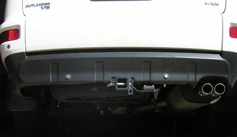

Here are a couple of pictures the Mitsubishi Australia towbar. The lower bumper needs to be trimmed for the receiver but everything else is a straight fit. The brackets seem very robust with 5 bolts per side.
RoGuE do you know that the 1600kg capacity is only for v6's? For 4 cylinder engines the capacity is 1500kg.

The one quadcam pictured is different from the one you pictured Rogue. Any more information on the one you pictured with the square receiver quadcam?
